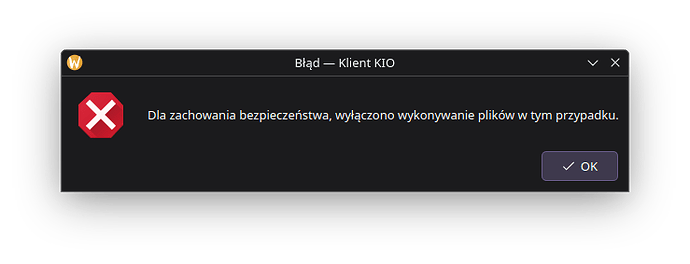

I downloaded the app myself and I asked my browser to launch, which prompted an error message, probably the same one you have (I can’t read Polish).

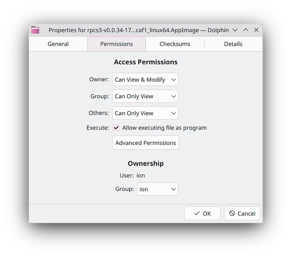

The solution was to open Dolphin, find the AppImage, right click on the AppImage, go to Properties, then to Permissions and tell Dolphin to launch the AppImage as its own thing.
In the terminal, you can find the AppImage and make it executable with the command chmod +x file_name_here.AppImage.

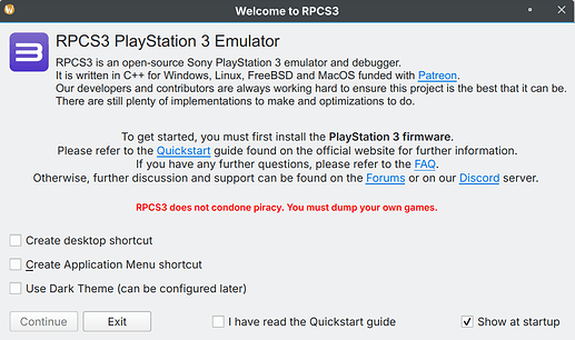

Not sure why it’s not working for you. I downloaded the rpcs3 to my desktop and just double-clicked the appimage and had no issue.

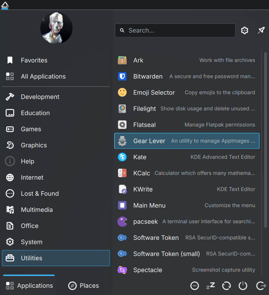

You could try Gear Lever, an alternative to Appimage Launcher.

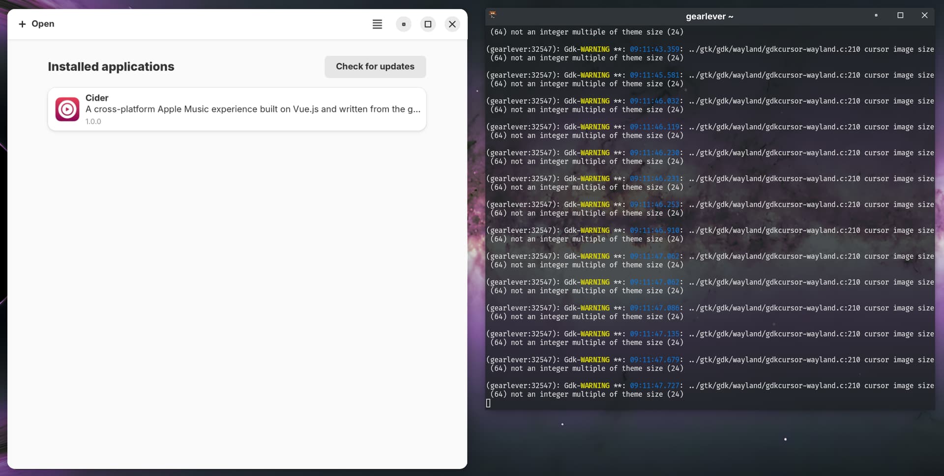

[ja@ja-ms7c56 ~]$ gearlever
Logging to file /home/ja/.cache/logs/gearlever.log
(gearlever:48036): Gtk-WARNING **: 15:58:01.215: Unknown key gtk-modules in /home/ja/.config/gtk-4.0/settings.ini
(gearlever:48036): Adwaita-WARNING **: 15:58:01.272: Using GtkSettings:gtk-application-prefer-dark-theme with libadwaita is unsupported. Please use AdwStyleManager:color-scheme instead.
(gearlever:48036): Gdk-WARNING **: 15:58:02.789: …/gtk/gdk/wayland/gdkcursor-wayland.c:210 cursor image size (32) not an integer multiple of theme size (24)
execv error: No such file or directory
(gearlever:48036): Gdk-WARNING **: 15:58:06.783: …/gtk/gdk/wayland/gdkcursor-wayland.c:210 cursor image size (32) not an integer multiple of theme size (24)
(gearlever:48036): Gdk-WARNING **: 15:58:10.079: …/gtk/gdk/wayland/gdkcursor-wayland.c:210 cursor image size (32) not an integer multiple of theme size (24)
(gearlever:48036): Gdk-WARNING **: 15:58:12.708: …/gtk/gdk/wayland/gdkcursor-wayland.c:210 cursor image size (32) not an integer multiple of theme size (24)
I get this log
If I run gearlever from terminal, I get that as well, but it still opens…

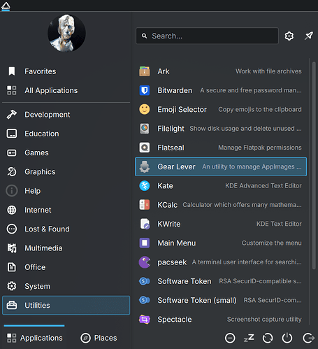

Why are you opening it from the terminal? Try clicking the icon in the application menu…
It still wont work. If u wont some info about my pc or sum just ask if that helps

The first error message: ‘For security reasons, we have disabled file execution in this case.’ i.e. missing x (run access right)
Moreover not all versions are complete or like KDE.
Download as an example from here
faine
chmod +x ~/Downloads/rpcs3-v0.0.34-17476-15937044_linux64.AppImage
replace Downloads to Pobrane if I’m not mistaken
