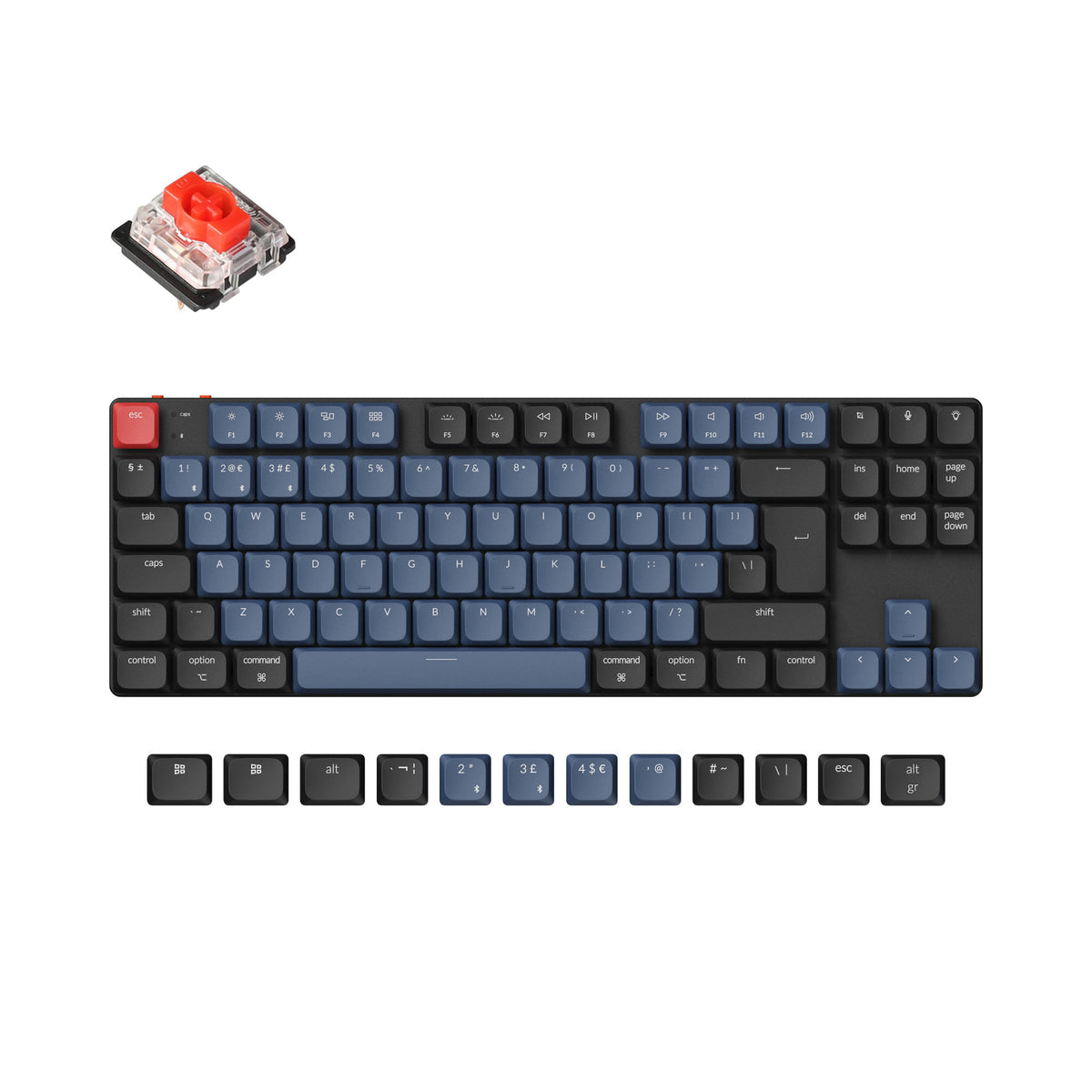

Thank you all. As expected, that’s quite a lot of information.
I think I have understood the most important things. I probably won’t be able to avoid a visit to a computer store. I need to feel the keyboard and the keys with my fingers.
Some RGB bling bling would be nice.
Hot-swappable switches are a must
The size, whether 65% or 80%, remains to be seen.
I don’t really need a numpad.
PBT keycaps, not translucent
A German ISO layout is very important
Now I just have to find out what Gateron low-profile switches are and what disadvantage they have
I think I could do quite well with the Keychron K1 pro.

The keyboard looks pretty good so far. The only thing you may need to ask support is the description says PBT doesn’t shine through (As in LED) but the option says LED PBT backlight so you may need to check this. But what it could mean is the LED will only shine under the caps and the letters won’t shine any light. Seems like good keycaps too on this keyboard too.
I have never used Gatreon, but what I know is in terms of colours is the colours can be the same as Cherry, such as brown but the weight and travel can be different. Just wanted to let you know in case you read about red or brown switches but it could be referring to Cherry in forums, or even other switch makers. but Gatreon is a good manufacturer of switches from what I recall.

I can take something from every post here. The linked keychron would be just one example of what would appeal to me. Appearance and ISO layout should fit.
I have set myself a budget of max. 150€. This would still be within the range :wink:
Many thanks for your views.
Unfortunately, the V series does not have a German ISO layout
I think the K1 with German ISO layout is in my range of possibilities.

Gateron is just a brand. Low-profile switches are for low-profile keycaps. The only real disadvantage is they generally have less overall travel. However, if you are not accustomed to a different mechanical keyboard, I doubt you would even notice that. The advantage of low profile keyboards is that they are lower which may mean a more comfortable typing angle. Of course, that depends on how you type.
