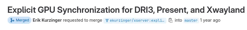

From [1]
The latest GNOME 46 desktop environment already ships with explicit sync support, which should also be implemented in the upcoming KDE Plasma 6.1 desktop environment release, due out in mid-June 2024.
[1] https://9to5linux.com/explicit-gpu-synchronization-for-xwayland-is-now-finally-merged-into-xorg-server
