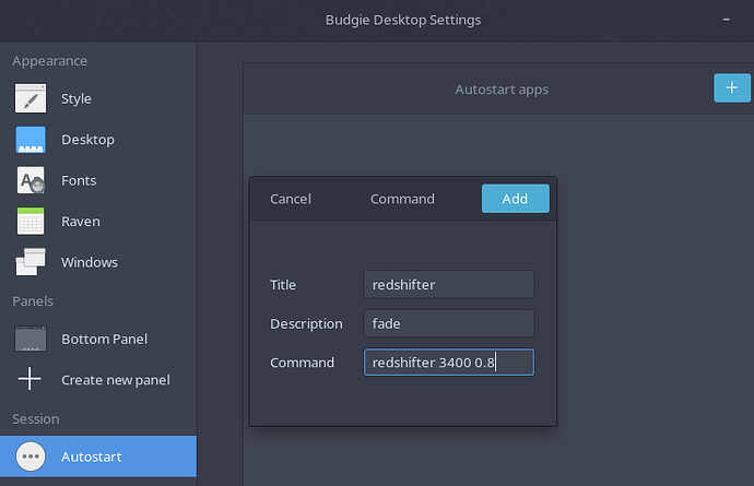

Strange. I entered as command in autostart
redshifter 3400 0.8
rebooted and worked.
New installation with Galileo Budgie
yay -S redshifter (was done first of course)
I can repeat from scratch. It takes less than 10 minutes
