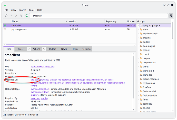

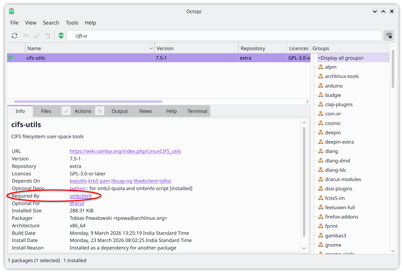

In EOS/Arch uninstalling cifs-utils package will lead to impact on smbclient. As smbclient has a hard dependency on cifs-utils package. And without smbclient, samba package will not work. Again a hard dependency between samba package and smbclient package. So tread carefully.

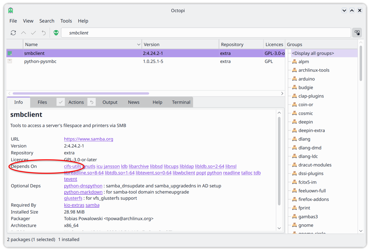

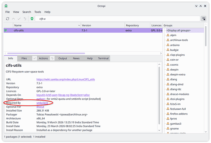

Yep and attempting to remove cifs-utils also does not work. It throws an error.
$ sudo pacman -Rn cifs-utils
checking dependencies...
error: failed to prepare transaction (could not satisfy dependencies)
:: removing cifs-utils breaks dependency 'cifs-utils' required by smbclient
$ sudo pacman -Rn smbclient
:: removing smbclient breaks dependency 'smbclient' required by kio-extras
:: removing smbclient breaks dependency 'smbclient>=4.24.2' required by samba
$ sudo pacman -Rn samba
:: removing samba breaks dependency 'samba' required by kdenetwork-filesharing
