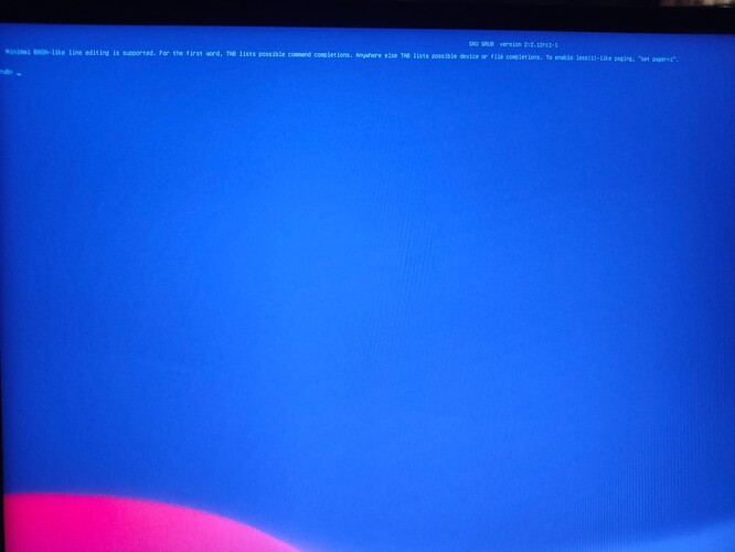

Another grub problem, CMD line instead of menu entry
Hello everyone,
After my last time a couple of weeks ago I’m stuck again on grub with something I can’t figure out on my own this time.
After turning the PC on, I wasn’t presented with the typical grub menu items to choose from but instead I’m thrown into this screen
Looks like it’s throwing me in the CMD line instead of allowing me to choose the kernel…

the error
1 of 2 a start job is running for /dev/dis/by-uuid/93d5c885-439f-b0f3-6e6e4620cb3f
2 of 2 a start job is running for /dev/mapper/luks-2e427ab1-0cad-4174-ab69-b379a0f2e1bc
what happened
this morning i booted normally and was presented by grub cmdline instead of grub menu.
after numerous attempts, i successfully chrooted and reinstalled grub with install and mkconfig.
i noticed an /efi folder and deleted it, no idea why it was there
checking etckeeper, there are no differences in etc files from yesterday. ysterday it was booting perfectly
specifically, i searched closely for fstab, crypttab changes and nothing is there.
i did update the system which contained the kernel but there was no grub update
additionally, dracut rebuild was triggered.
this was on the 12 of august, the pc worked just fine on the 13th. only a daily autocommit was made by etckeeper with no changes
etckeeper git diff from aug 12th commit to todays show no relevant changes
this is EOS on btrfs on LUKS encryption.
question
why is systemd stuck on those 2 jobs when i can perfectly open the crypto partition from live usb and furthermore i can mount it and use mount -a when i chroot into it?
i’m a bit discomforted, was just about to go on a trip and looks like i’m fucked right on time
