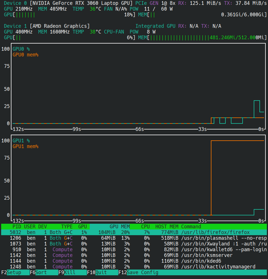

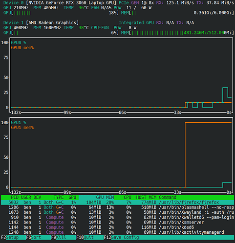

According the output from nvtop, It looks like most of the memory for the processor graphics is being used (I’m sorry this is a picture, couldn’t figure out how best to capture the output):

Your bios might have an igpu memory allocation setting, you might be able to increase it to 1GB.
