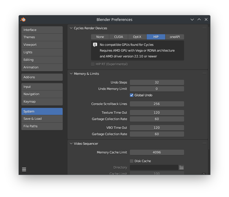

For me it then looks like this:
Bildschirmfoto vom 2023-08-21 17-08-23

I don’t even know how to use Blender. Where do you open this window? Just curious if it shows my RX590?
Go to Edit in the top left corner, then click Preferences. On the left side of the Preferences window, click System and select HIP.
