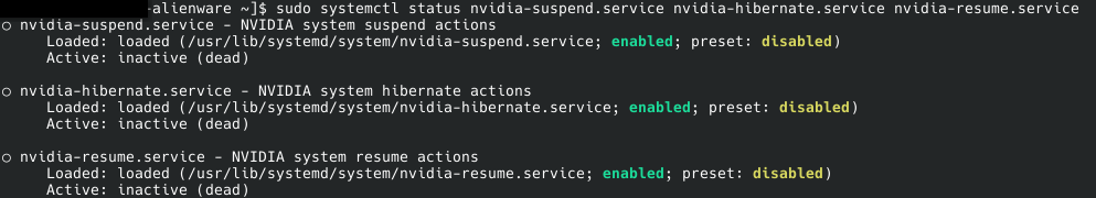

Also do you have the services set up for
nvidia-suspend.service
nvidia-hibernate.service
nvidia-resume.service

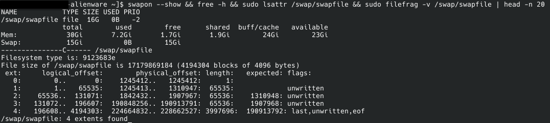

Do you have the proper swap space, partition or swap file? You may also need the following parameter NVreg_PreserveVideoMemoryAllocations=1

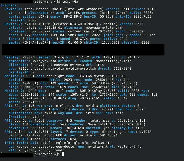

Thanks for helping. Here is the return you asked for, and the suspend, hibernate and resume services are active. I’ll attach another screenshot at the end.
I have a swap file. It used to be 500Mb. I’ve resized it to 16Gb recently while trying to troubleshoot this issue.

It may have that paramater automatically now with the newer 590xx series drivers. I see it’s rendering on the intel gpu. Are you using some method to switch to the nvidia gpu? Otherwise it’s suspending and resuming on the intel gpu.
I’m really not. I am not aware that I can and I don’t know how to yet…
The only things i know is that i can only run the secondary monitor off the dGPU(nvidia) due to the way the DP port is made in the laptop, but I never looked into switching the built-in screen to the dGPU. Do I understand that correctly, that you think i should switch my laptop built-in screen to run off the dGPU, or like make the whole system run on the it? And avoid using the iGPU completely then? I didn’t really consider this as an option because i thought it will just put additional load on the dGPU that can be handled by the iGPU.
I’m sorry, I wish I could understand you faster… I can get some general terms, but I’m not aware of how things run in-depth…
P.S. Monitor-2 is the built-in screen, and Monitor-1 is secondary
Okay so I’m not understanding exactly. Is the secondary monitor the one staying black? It does work though? When you have it plugged in and it is working what does inxi -Gaz show? I want to see if it is automatically outputting using the nvidia gpu on that port?
I was referring to the first uploaded screenshot when I said Monitor-1/2, this is how they are named there.
In my case “Monitor-1” is the secondary monitor on that screenshot, its the one running on dGPU, it is also wide 2K 2560x1440.
”Monitor-2” is the built-in monitor, the one that runs on the iGPU, and this one is 2560x1600.
Sorry for confusion. They are likely named like this because I recently(before your first reply) selected the auxiliary monitor as primary in settings in hopes that it might fix the issue, but it didn’t. I still keep it as primary tho.
