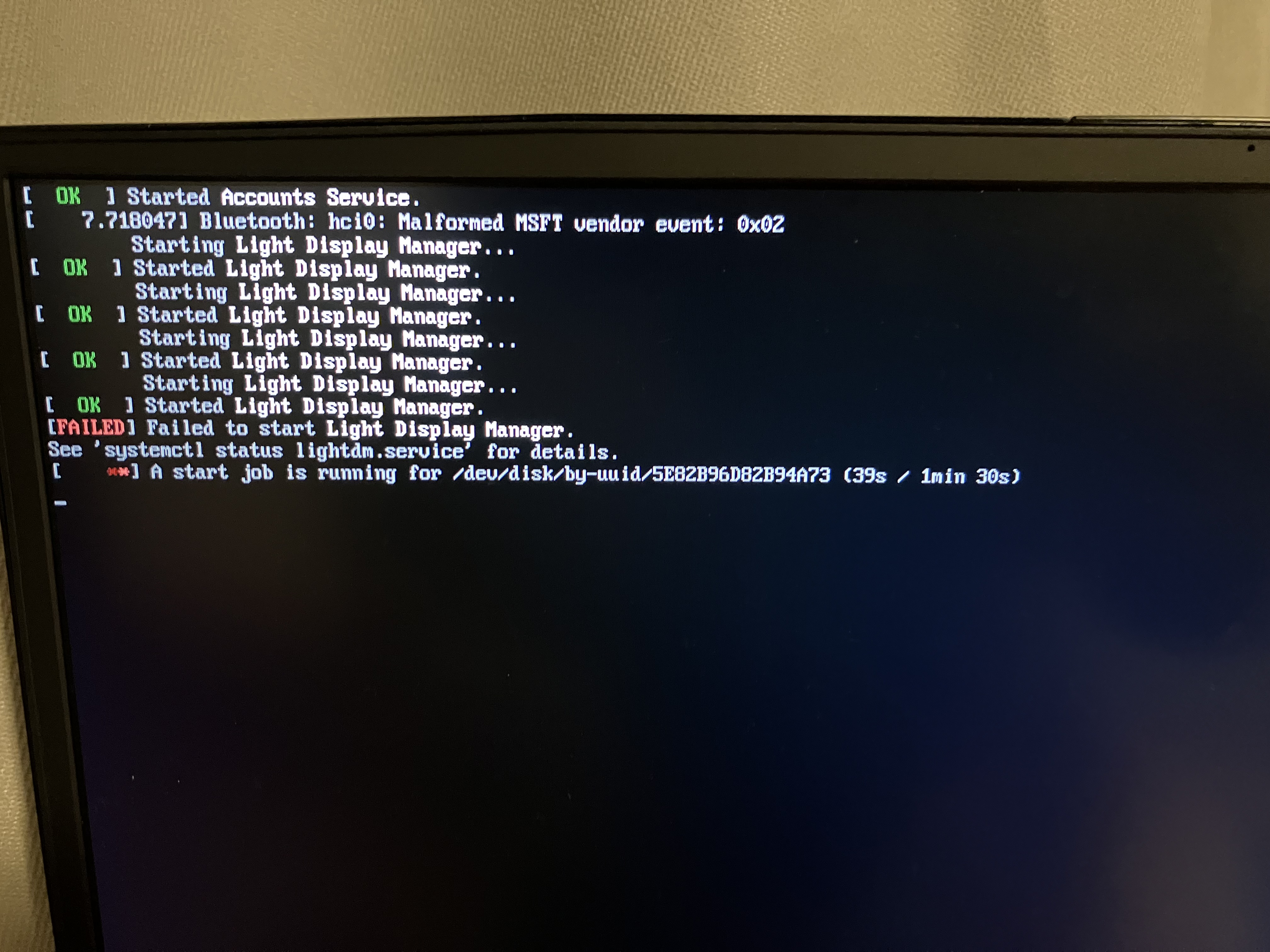

After updating yesterday (12/23/2024), system gets stuck repeatedly starting Light Display Manager
Updated my computer yesterday and shut it down. This morning when I tried to boot it up I couldn’t even reach the login screen - the system seemed to get stuck starting the Light Display Manager over and over.
This seems to happen whether I boot in 6.12.6-arch1-1, 6.6.67-1-lts, or their fallback versions.
What can I do to fix this?

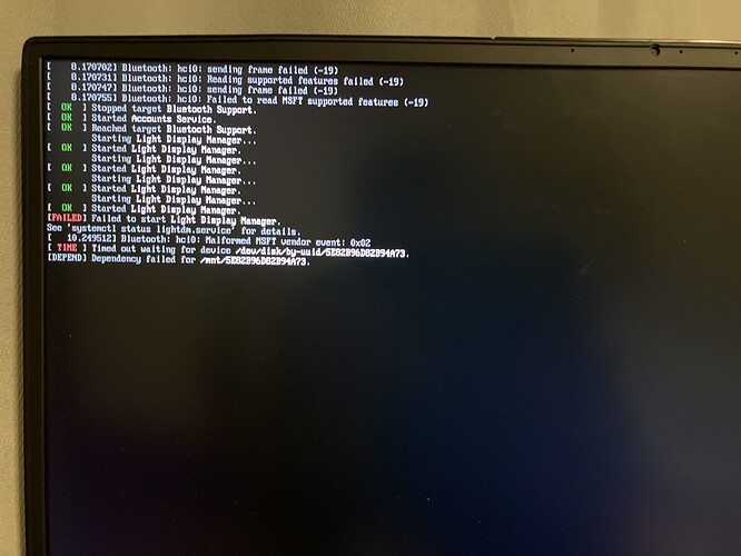

Edit: tried again and this time waited. Now I’m stuck on this.
