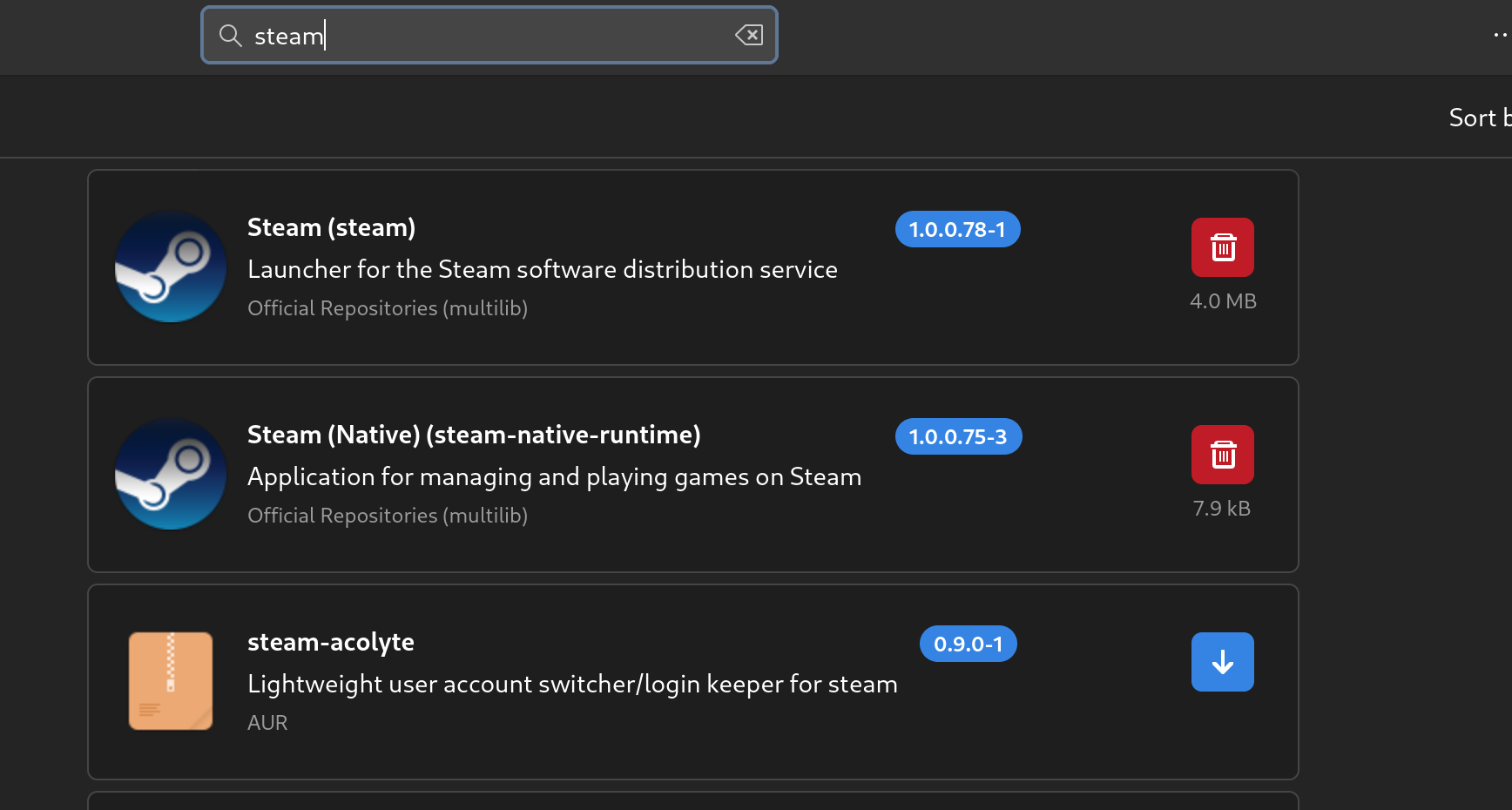

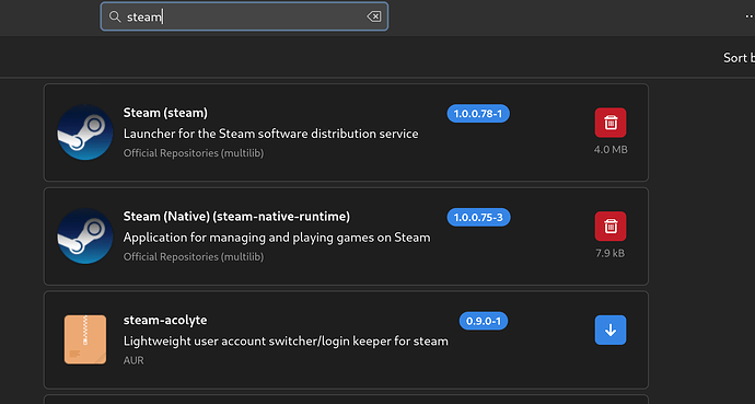

I don’t see a Steam AUR package?

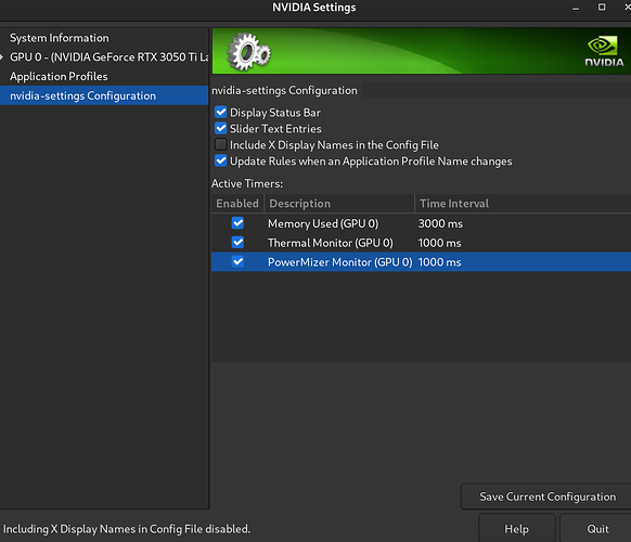

Also my nvidia settings I cant see anywhere set FPS?
My steam in PAMAC says official repositories? i assumed that was AUR?

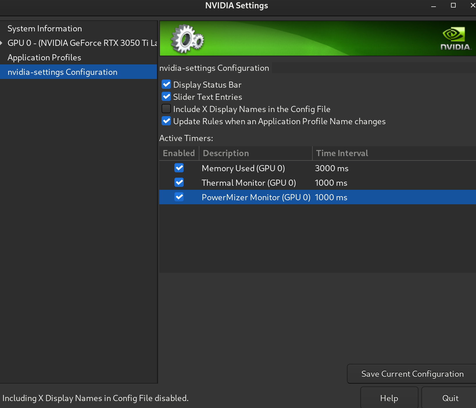

It looks like you are using a Wayland session when I look at your nvidia-setting screenshot. What happens when you switch to an Xorg session?
No, when you have the Flatpak installed you get an additional menu item. I just use a menu item to open Steam.
yeah I been running Wayland…Will try Xorg later.

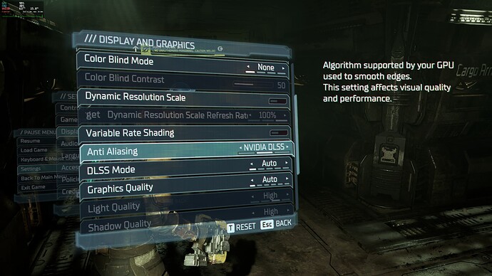

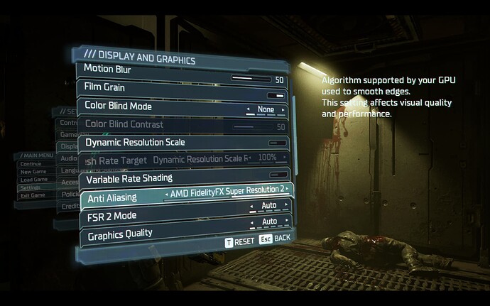

Thats good. I installed Flatpak and Steam and the Game runs in Flatpak…but I noticed in settings it is not using the NVidia driver in the anti aliasing settings? Does that mean the game is not launching via the Nvidia driver?
I am worried if I switch the setting to use Nvidia driver it might not load again …it seems a bit jerkier with this amd setting instead of nvidia?
That doesn’t select the driver just what type of AA to use, since you have an Nvidia gpu that should be Nvidia DLSS. I ran it with Nvidia DLSS as well.
before yesterday I could see the Nvidia DLSS option but after update today and reinstall, it’s not available now…just AMD and TSS or something…So I feel there is definitely something wrong with my Nvidia driver… I might have to try to downgrade the nvidia driver unless nvidia comes with a fix for all the other dead space players who saying its due to new update in nvidia…? The resolution seems lower for sure on this AMD setting…

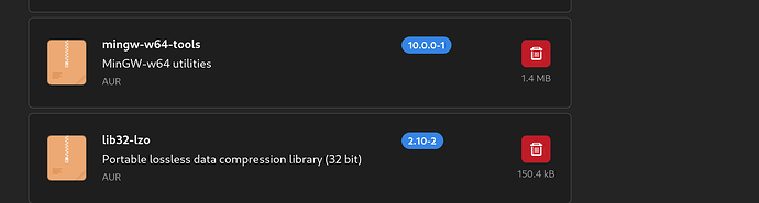

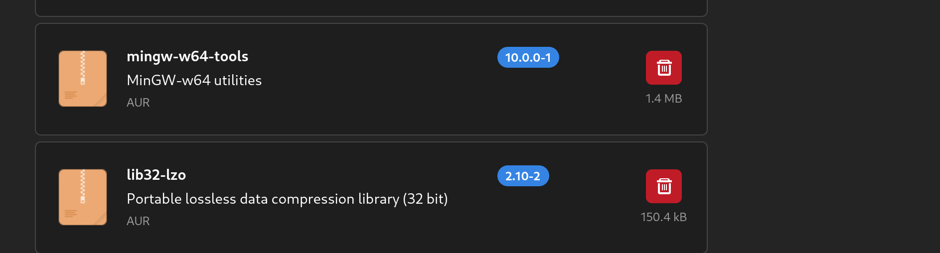

I can see these two were recently updated…wonder if the problem is related to this
? because during the upgrade process I definitely saw the word nvidia pop up in the log while updating evreything
I want to try that…how do I change to this driver exactly?
actually says I am using same already? Which kernel are you using?
