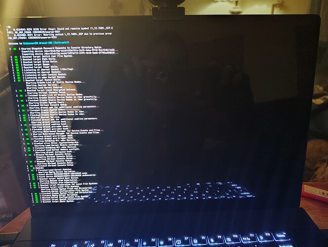

After installing NVIDIA drivers I go to a blank screen and I can't get to TTY
After installing NVIDIA drivers I load to a blank screen and I can’t get to TTY
Also the keyboard keeps blinking in and out
Please any help would be dearly appreciated at this point if it’s driving me nuts

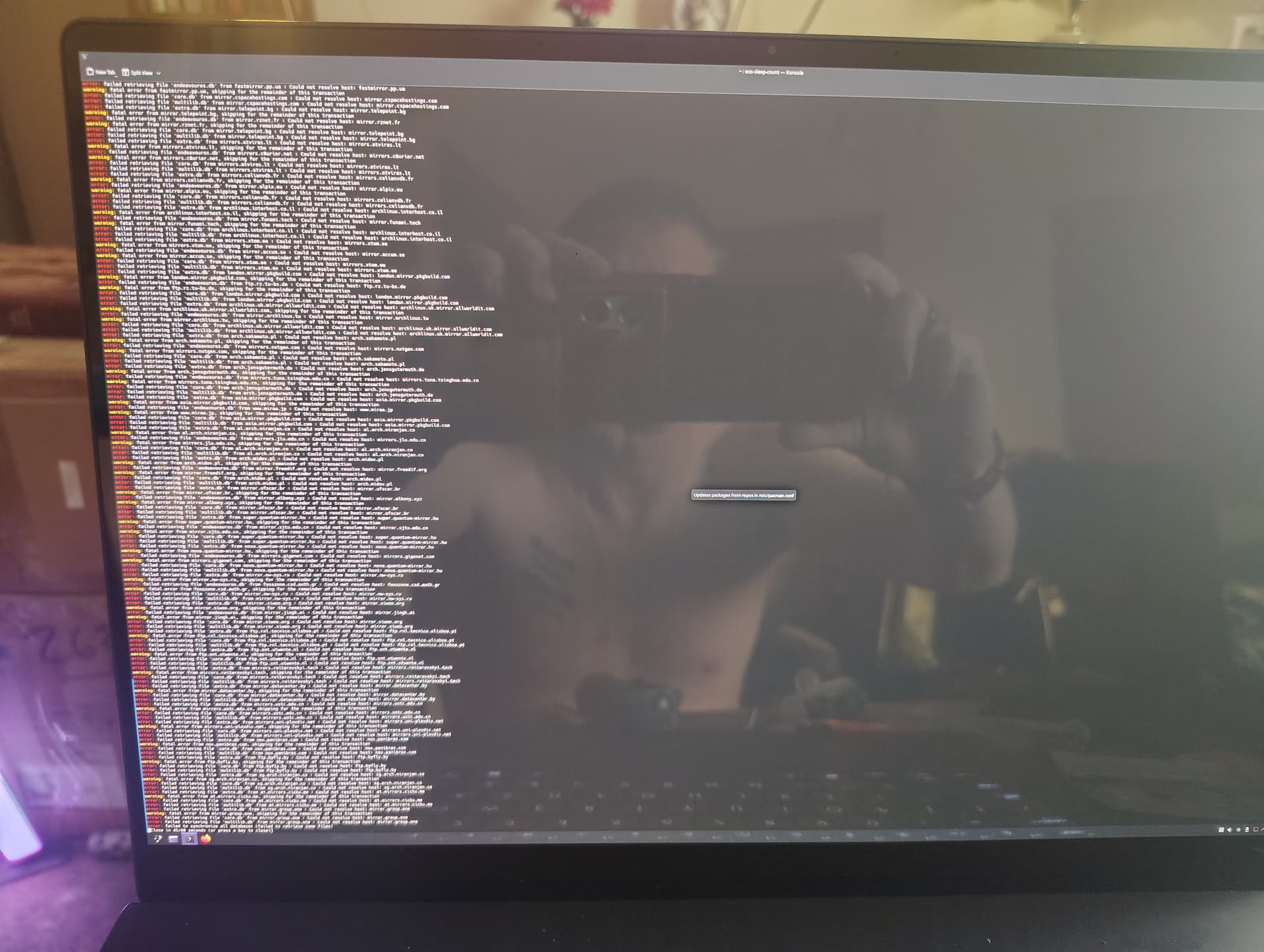

Also endeavor OS LTS gets me this
Which I still can’t get to tty that way either

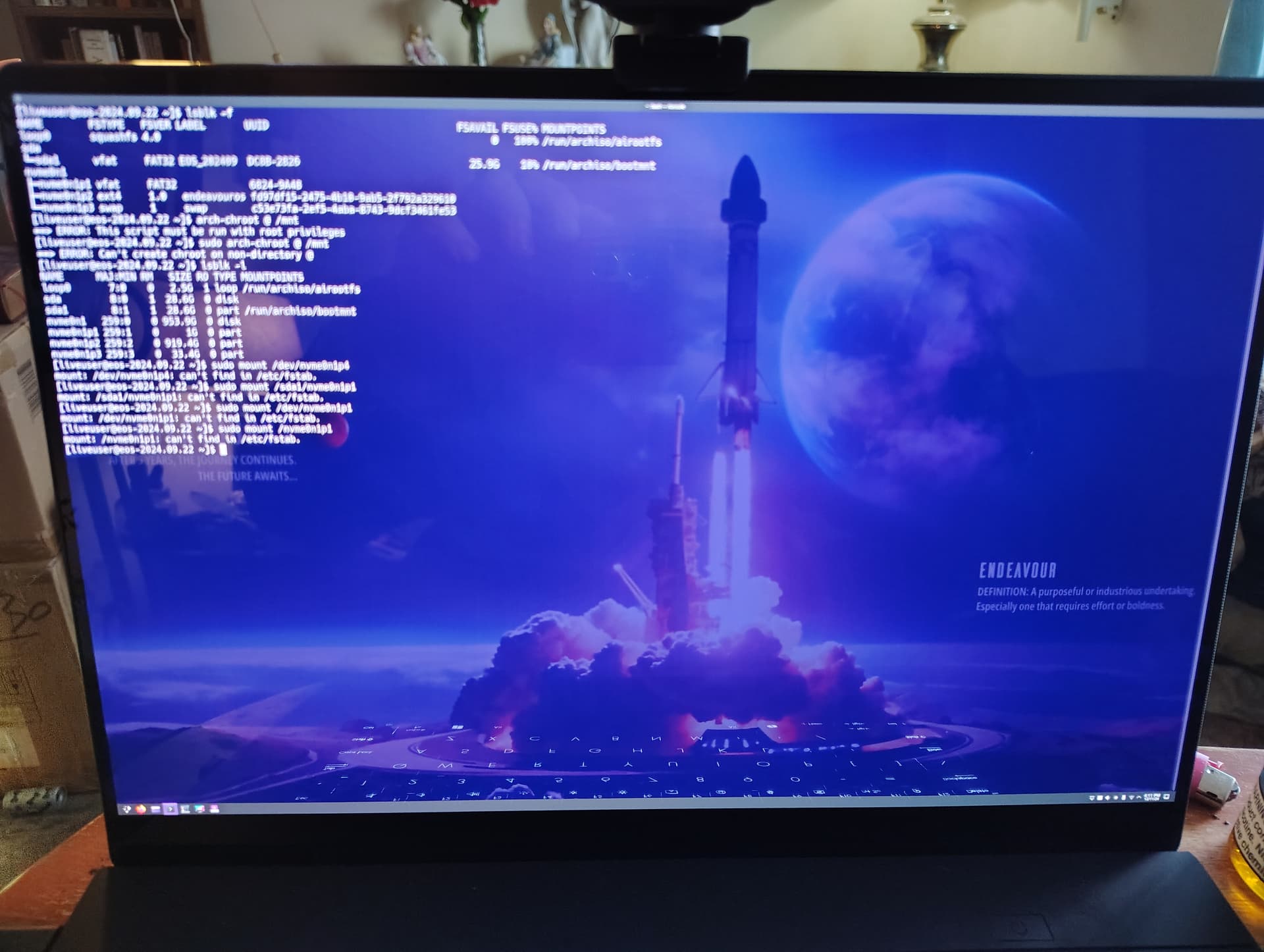

I think I have to chroot into the system from reading other forums but idk how to even do that to well
This is hopeless I can’t figure out how to chroot errr

Sorry you are running into these issues with nvidia. I was hoping you wouldn’t. I would stick with nouveau for now then.
As far as arch-chroot that should be fairly straight forward on this installation with ext4 if you ever have the need in the future.
https://discovery.endeavouros.com/system-rescue/arch-chroot/2022/12/

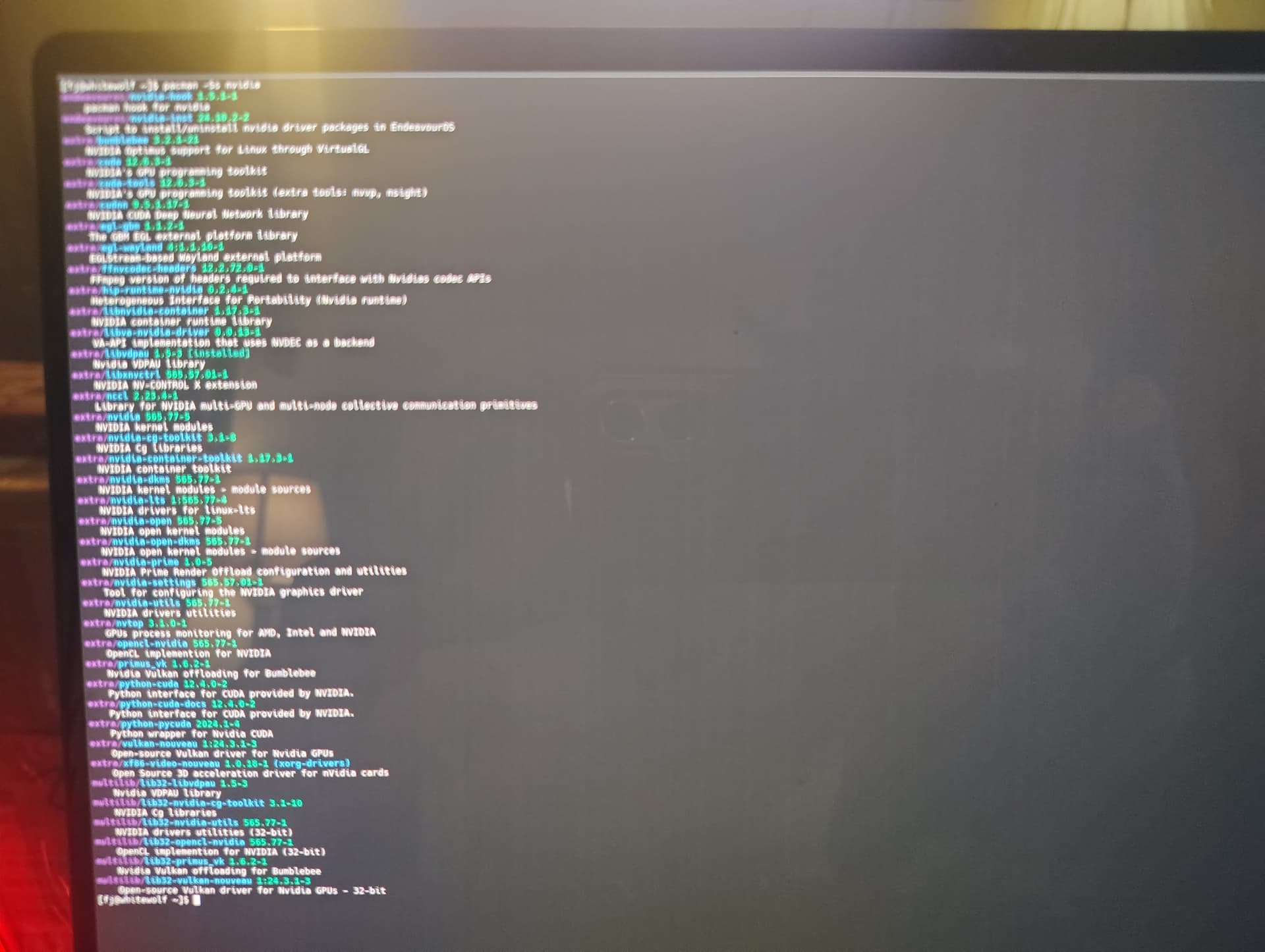

chroot is relatively straightforward and you should take the time to learn it since it’s a common way to troubleshoot boot issues on arch based distros. I don’t think you should stick with nouveau, there’s a solution to this, if you’re set on reinstalling, try to boot the install medium with proprietary drivers and have them installed with the os when you set it up.
I remember having a problem where nvidia-dkms only worked with lts kernel (should work with latest kernel too), and the nvidia (non-dkms) package only worked with the latest kernel (normal).
You could be experiencing that.
Maybe try something like nvidia-open on latest kernel, that should absolutely work unless ur using a rly old nvidia gpu.
thankx for the tech wisdom i really appreciate it i will do as you say the best i can resintalling now and getting all the drivers with this command: sudo pacman -S nvidia-dkms nvidia-utils lib32-nvidia-utils nvidia-settings

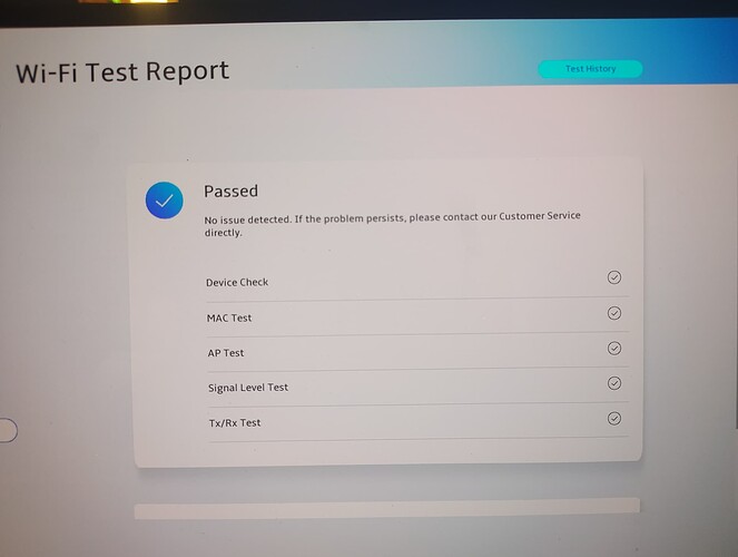

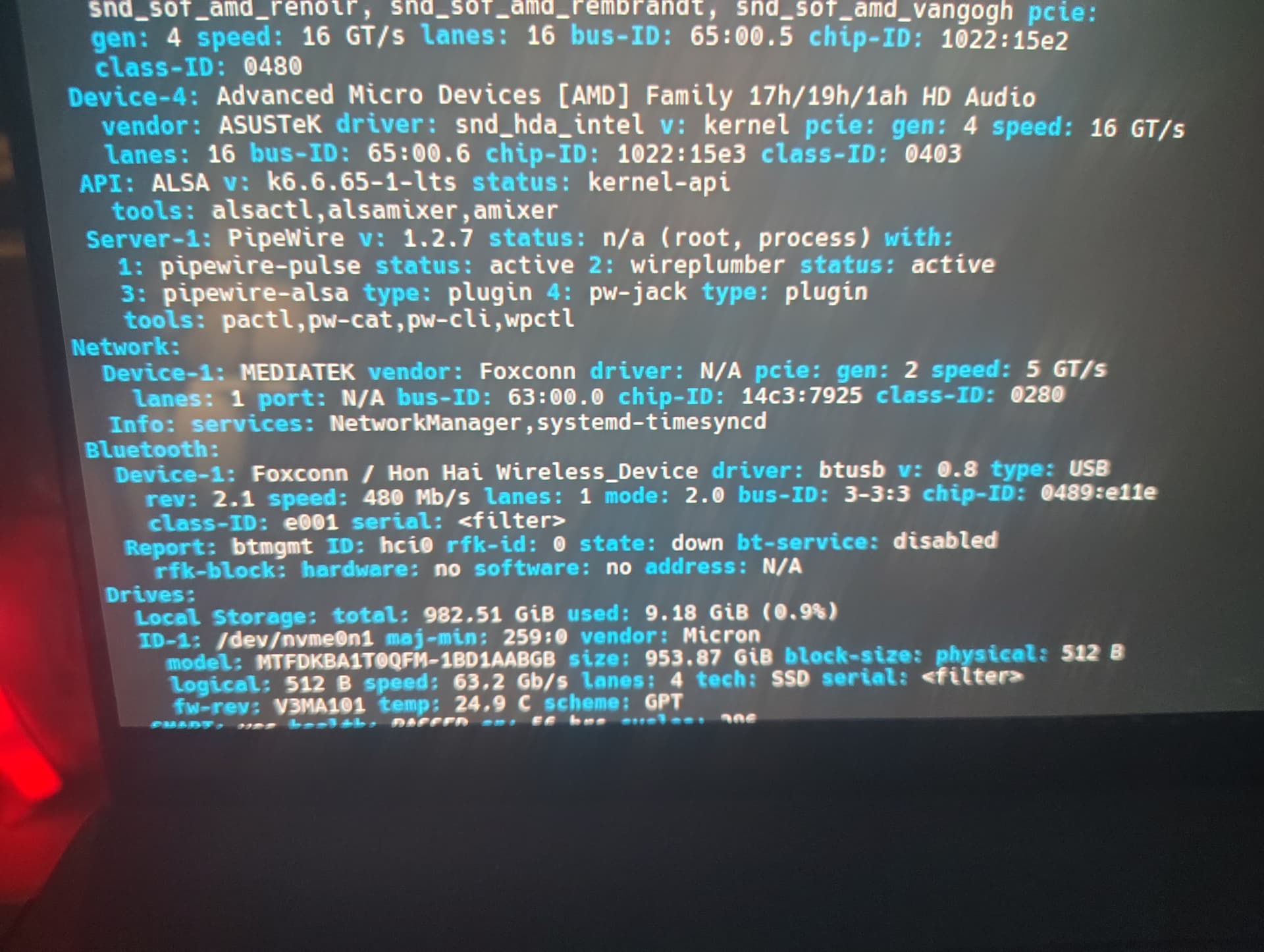

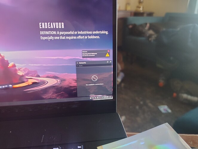

Okay so like I managed to get the NVIDIA drivers on there which still causes the computer to go black in the Linux kernel BUT in the linux-lts kernel it loads fine but with no ability to see my wireless network though unfortunately. I know my wireless is on and working but I can’t get EndeavourOS to see my wireless. again that is in the linux-lts kernel the regular kernel just Linux goes to a black screen when loading off I think the whole thing is a headache lol
I got the nividia video drivers on there the regular kernel doesn’t work and the LTS kernel has no wireless
The LTS kernel is working with the NVIDIA drivers but there is no wireless
If anyone has any suggestions how to get my wireless so that I can see my wireless or whatever that would be a huge help in the LTS kernel
I tried googling why wireless doesn’t work on endeavor os’s site and I couldn’t find much information that would help me everyone’s solution didn’t work for me :frowning:
The good thing is the Nvidia drivers work in the LTS kernel just no Internet

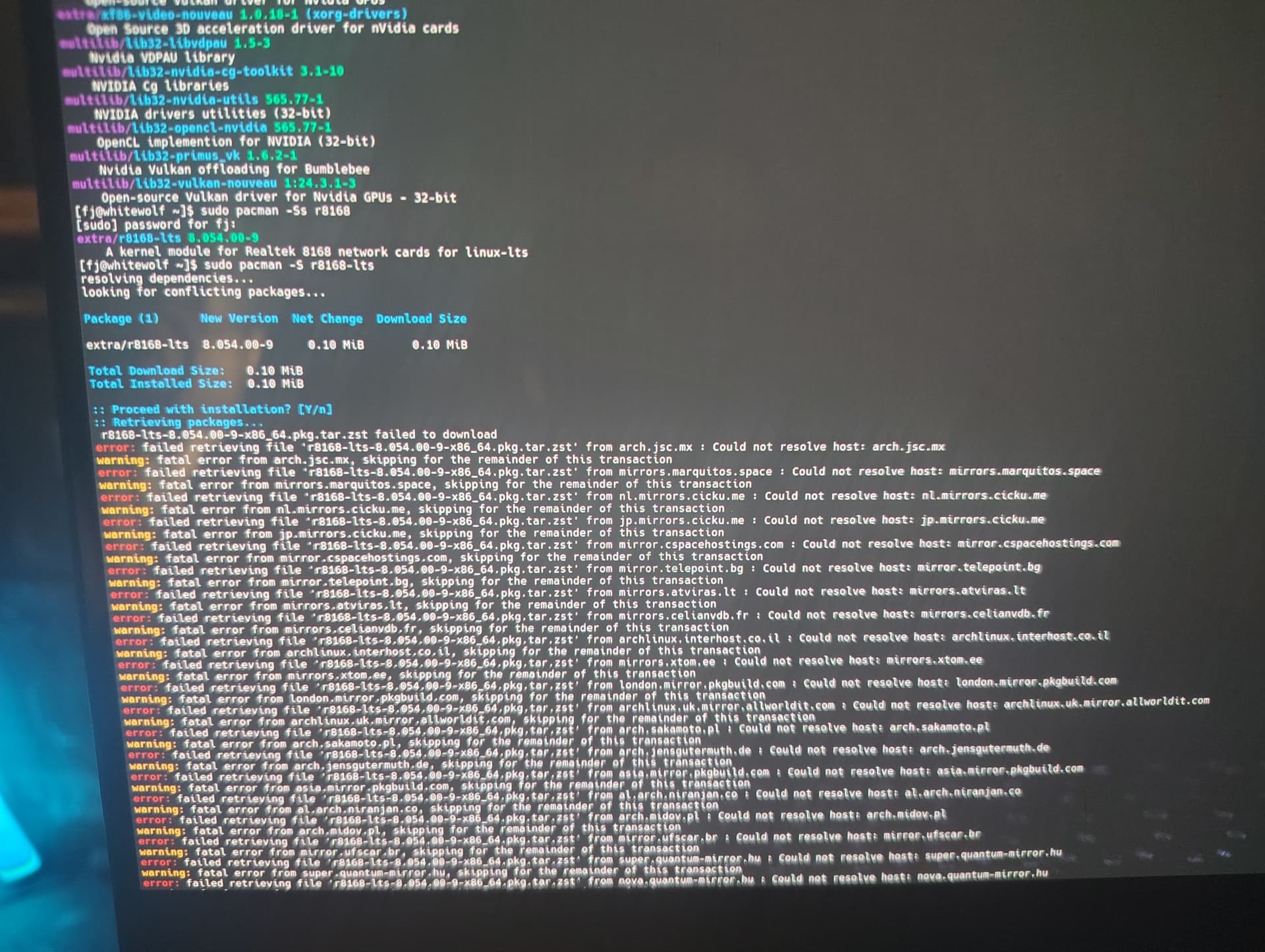

I tried to install r8168-lts no luck without an internet connection I wasn’t able to install it
Looks like I don’t have a driver installed
I don’t know what to do or how to install one without the internet

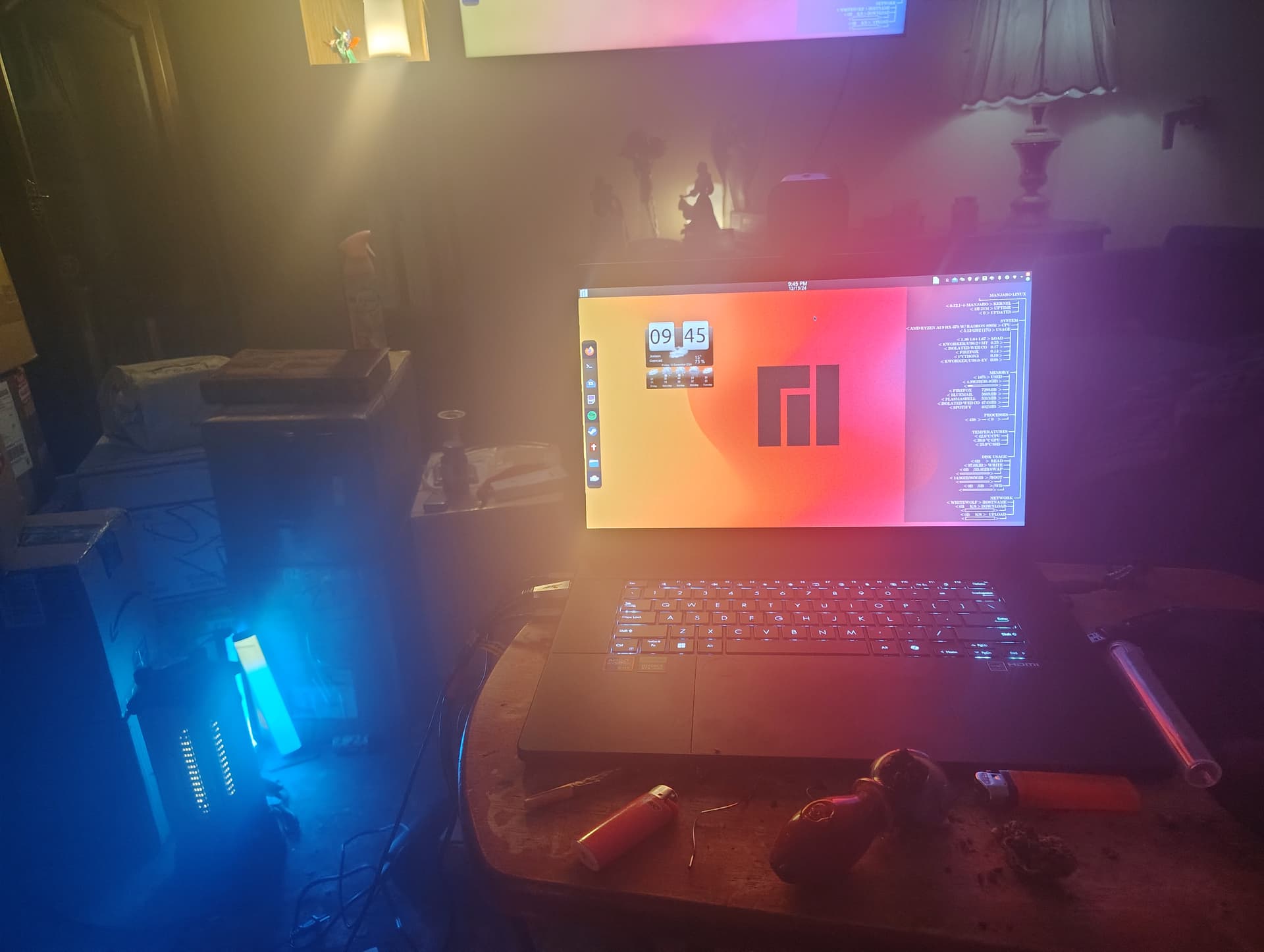

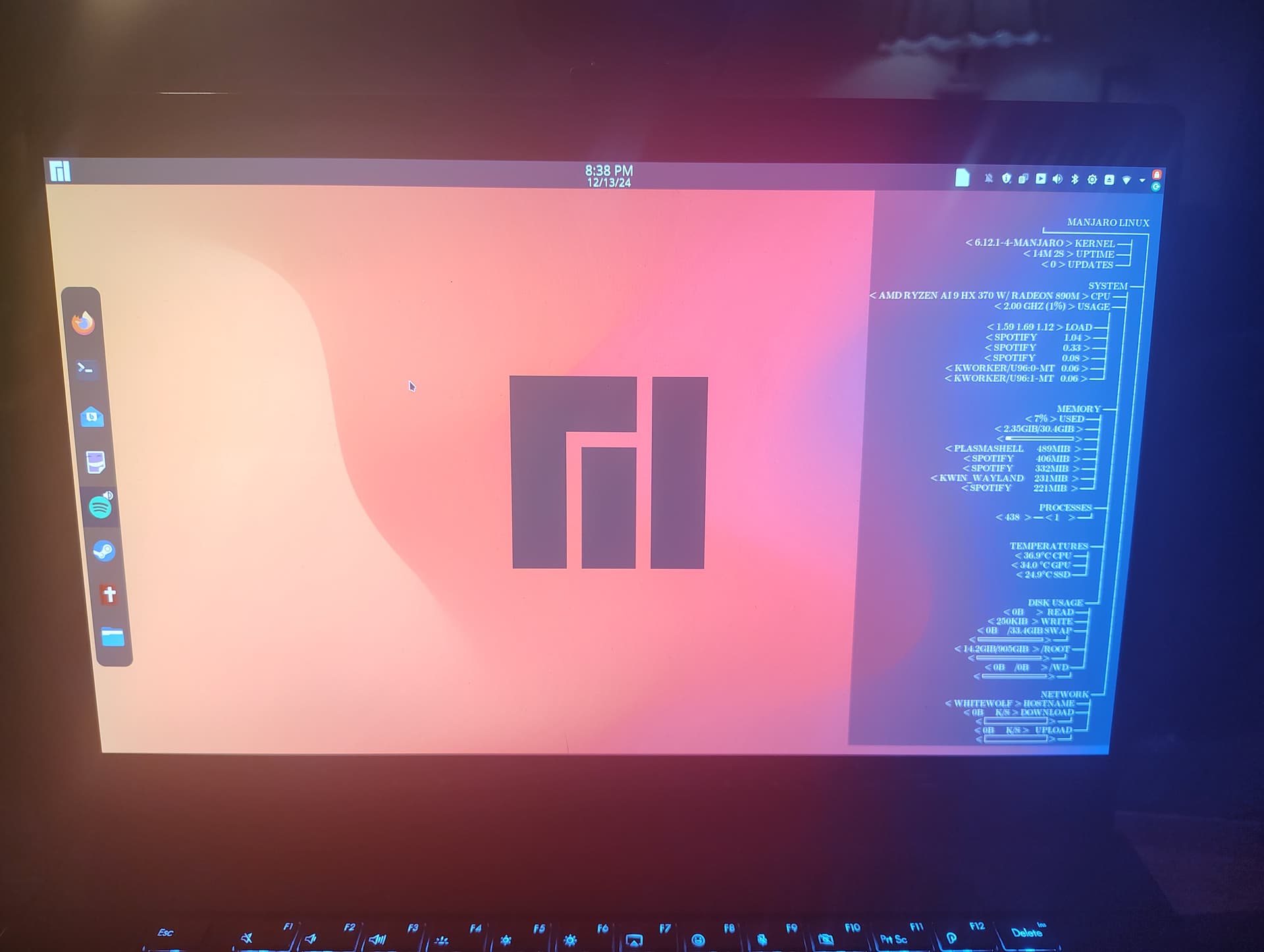

tbh i am trying to download majaro kde now if no one has any ideas i heard it works with nvidia drivers out of the box?
I ended up installing manjaro it does support NVIDIA drivers right out of the box
At least I’m in an arch based distro
