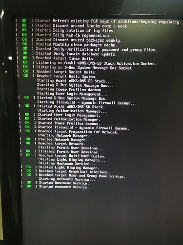

A weird XFCE desktop disappear when return from tty2
reproduce problem
log into xfce desktop. then trun to tty2(Ctrl+Alt+F2). then return to DE(Ctrl+Alt+F1). It will show many code just like the codes appear when boot. Nothing work but tty2. no mouse. no any window. Just black background and codes.

That seems the normal boot screenshot and startup of system services.
I am not sure about the problem but to my understanding seems you are having trouble switching from tty back to your desktop.

the screen is TTY1 (with the code lines) you need to switch back to TTY7 in most cases…

I think tty1 is DE desktop for a long time :cold_face:
depending …
yep. I try tty7 on Kds plasma. tty7 got nothing.
mine is on TTY2 :wink:
what ? which de you use?
it is caused by using LY as login manager …
On my XFCE4 install with lightdm it is on TTY7.
