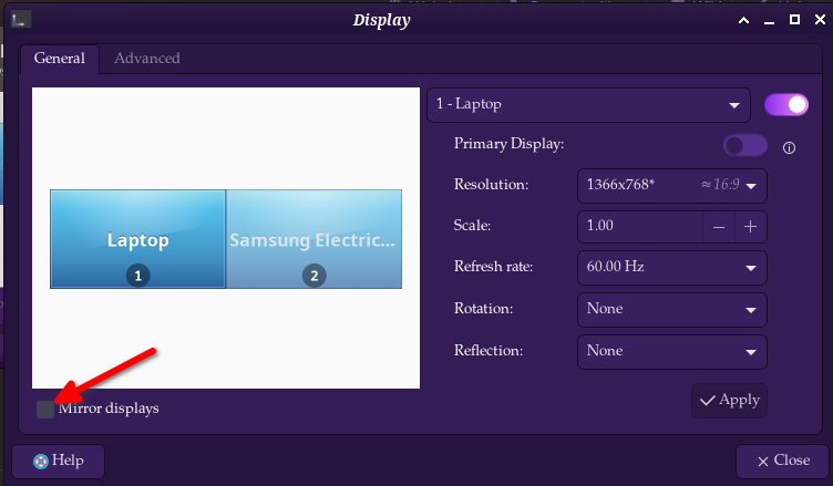

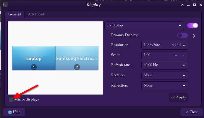

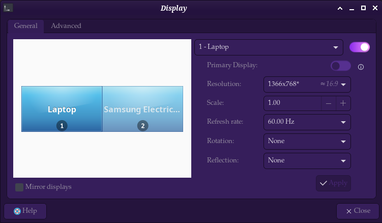

as for mirror displays , is this enchecked?
again, i’ on xfce and not sure about kde settings

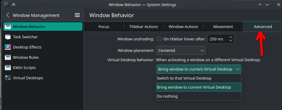

Apart from this check this:
Peace
Opening windows in KDE/Wayland mostly seems to follow the mouse.
