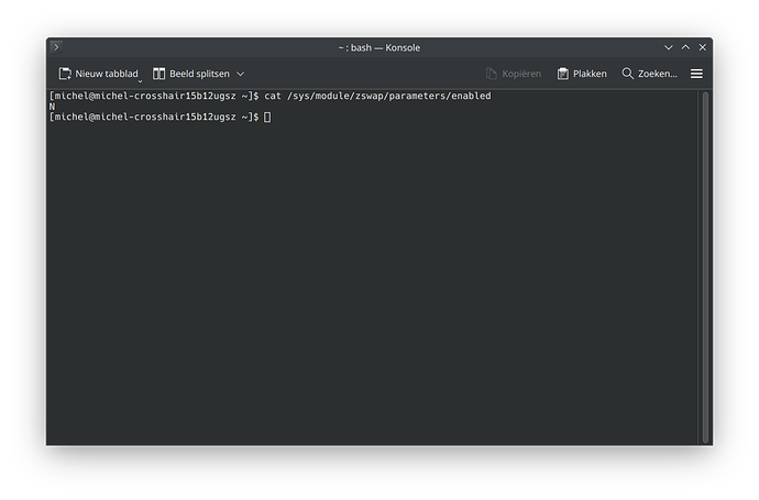

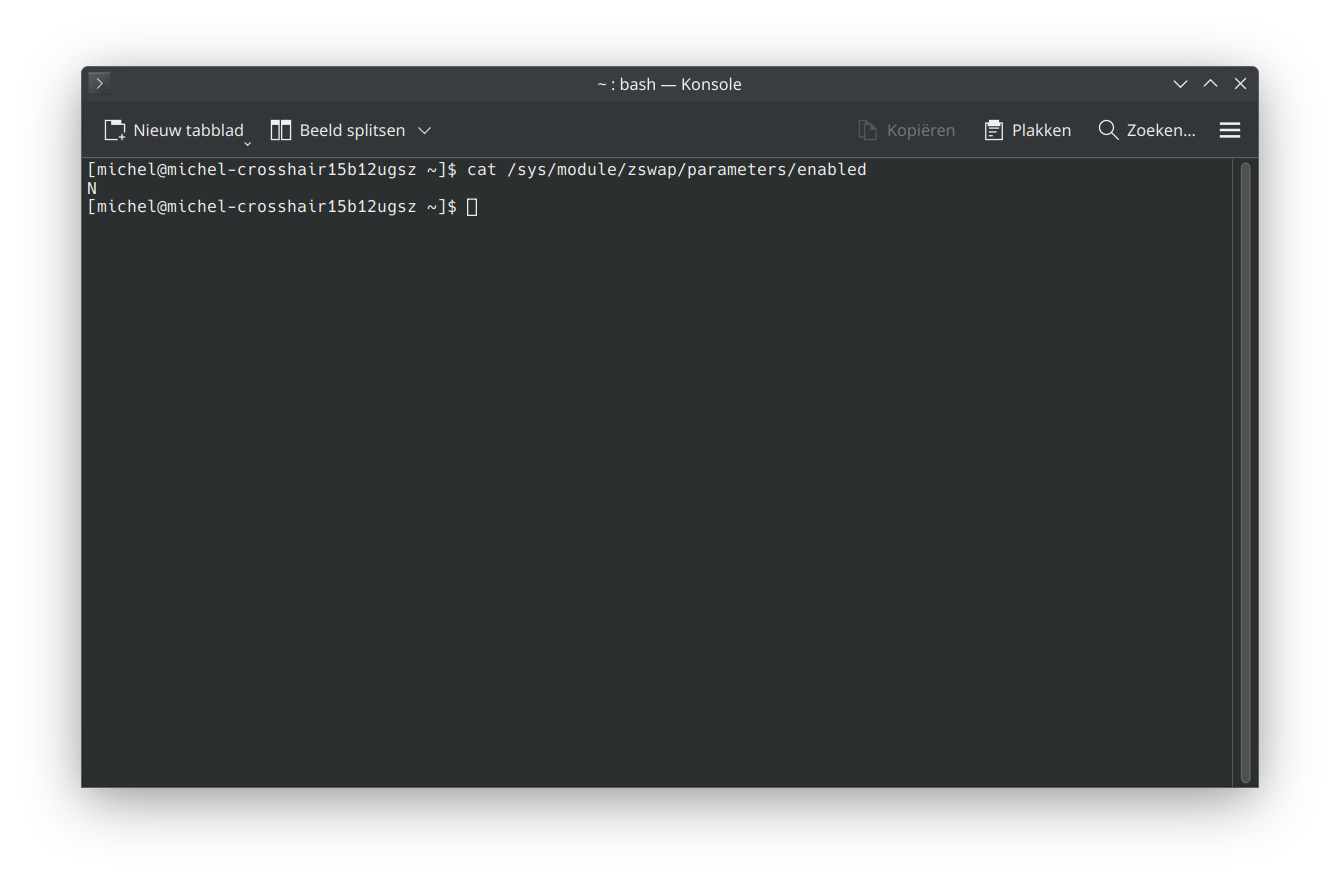

I just added zram to my gaming notebook (just in case).
Just don’t forget to disable zswap, otherwise zram will behave wonky.

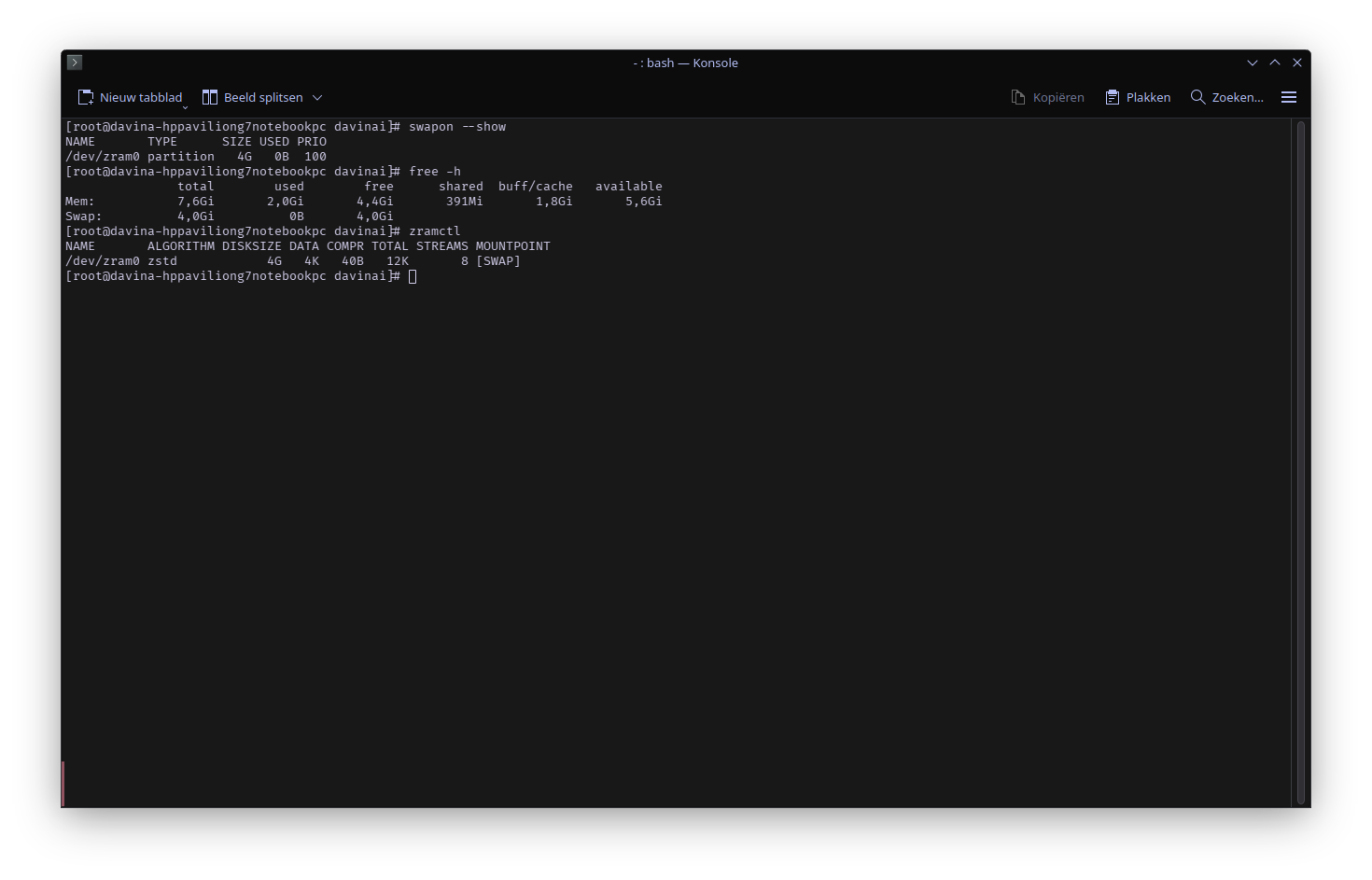

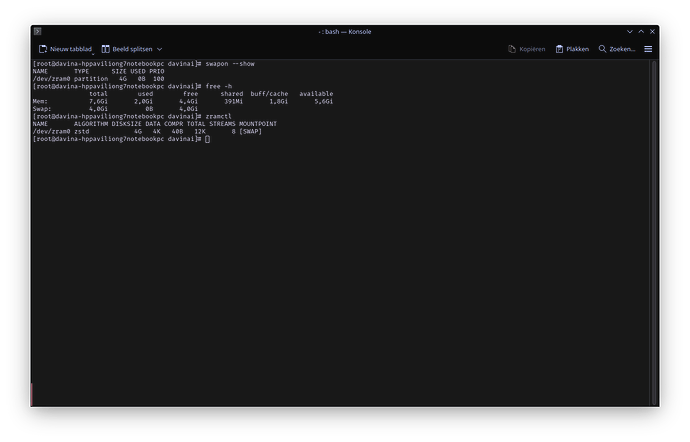

I did a clean install without swap yesterday, only enabled zram. Zram shows up as “swap” device.
The Arch kernels enable zswap by default, if you add a swap device it will kick in automatically.
If cat /sys/module/zswap/parameters/enabled gives you a Y it’s enabled.
See e.g. bullet point two here.
Thanks! turned it off.
