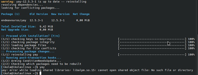

but its yay failing with the error or not? i see someone on telegram just now with exact the same error:
so there system was not fully updated..
Screenshot_20251213_225502
yay is now 12.5.6-1.
I get a different error message when installing pamac-aur, but the error tells pamac-aur depends on libalpm.so 15 (and not the current 16).
