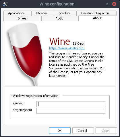

How are you building it? Independently from source?
Yeah. Going through the straight up git clone and working my way through, using ldd to try and find / patch in missing stuff with yay. Reminds me of when I built wayfire. That was a nightmare

Success. I was making it harder on myself than needed. This is all you need to do:
  • fetch wine-git out of the AUR
  • Open the PKGBUILD
  • Change the pkgver variable by substitution of rc(x) to rc4
  • run updpkgsums
  • iun 'makepkg -si
That’s it. Build time was about 15 minutes, and everything works.
EDIT: oh right, you have t reboot before the wine program loader will work
