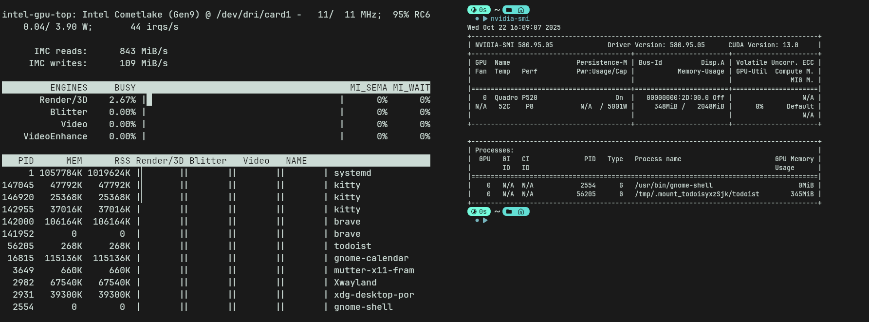

I initially thought its a Hybrid GPU switching issue, where all load is getting on either one of the GPUs, but after running nvidia-smi and intel_gpu_top, it seems like the load is getting balanced between both the gpu

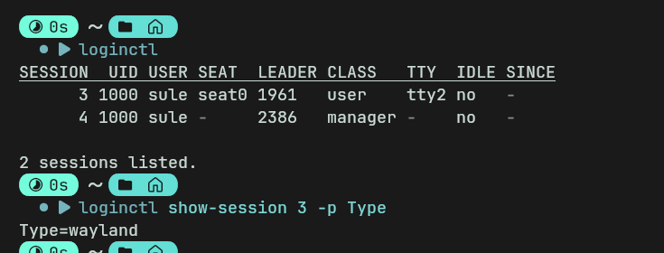

I am on wayland currently.

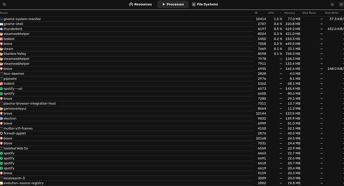

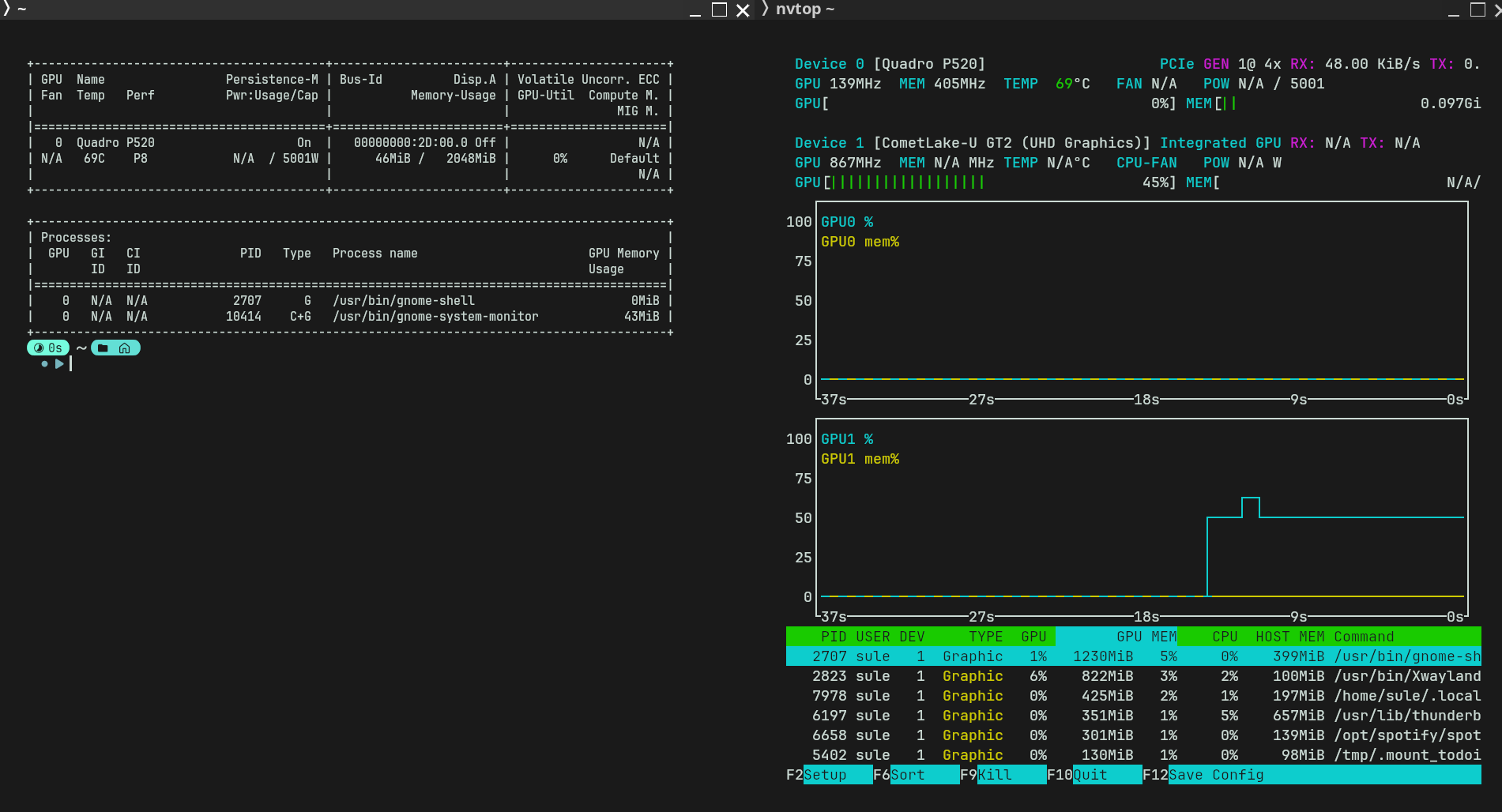

While checking some more on GPU switching, I came across supergfxctl, and decided to give it a shot, running it in Hybrid mode. And to stress test, I’m running a lot of things simultaneously and not running into any lags which is amazing, here is a screencap. Running a 4k video on brave, stardew valley, spotify, thunderbird, obsidian, todoist and a lot more things which I’m sure i wont run simultaneously again.
But running nvtop and nvidia-smi, shows that all load is being handled by the iGPU, which is surprising and also concering to me… how do I ensure that the nvidia dGPU is also getting used?

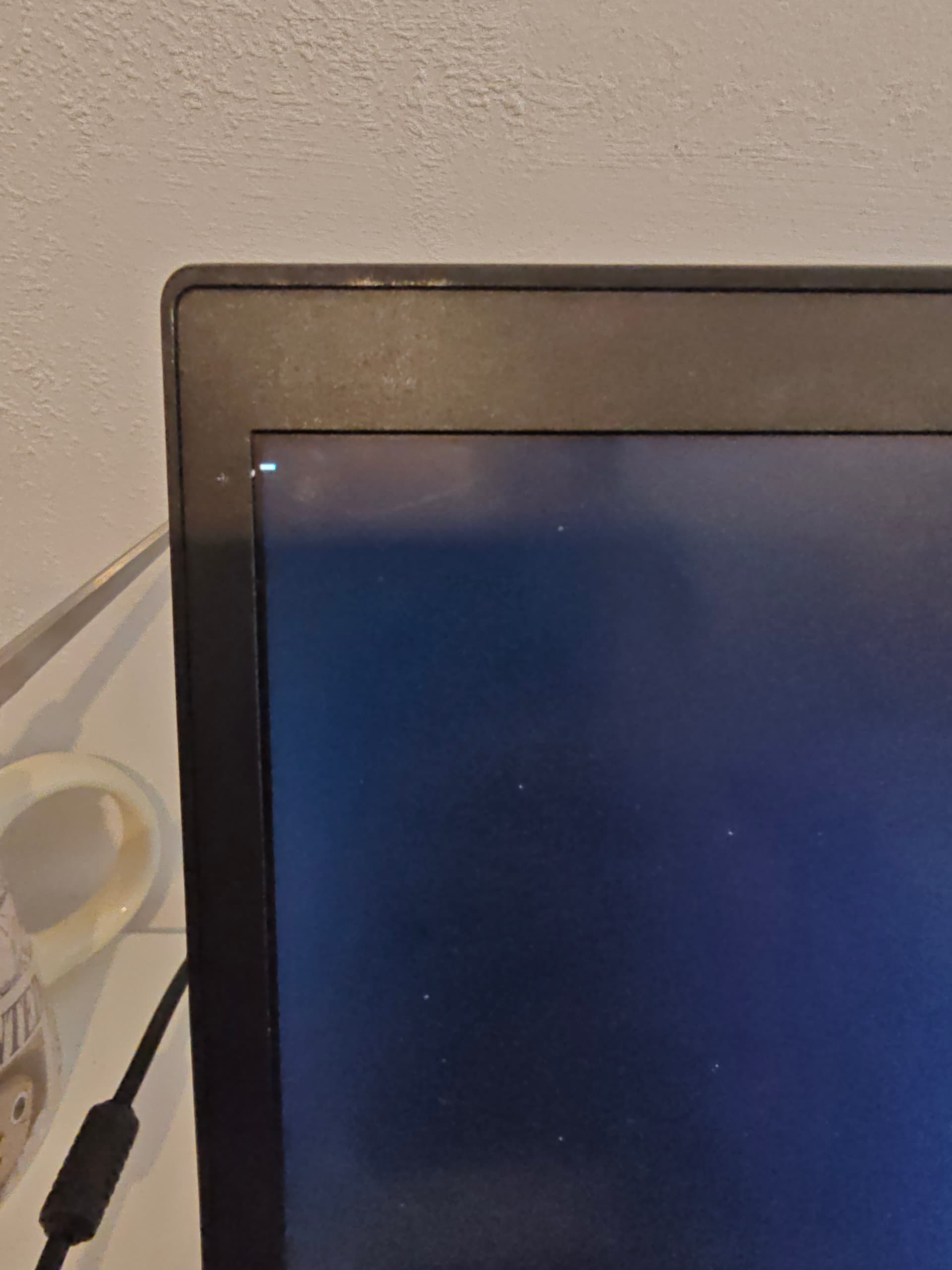

Hi, since today morning I’m facing an issue with Nvidia persistencd service failing to load on boot up. After refering forums, I decided to downgrade the Mesa package, since I could see it got updated yesterday.
But now, after rebooting the system, I am
  1. Still getting the Nvidia persistencd failure message
  2. I can’t reach the user details page. My GDM I believe, neither can I access any other virtual tty (Ctrl+Alt+F(1-9)) and my system is just a blank screen with _ blinking.
Please help me regain some Access on my pc, I tried logging into the fallback endeavourOS option (on the systems/grub menu) but to no avail
Note that with the USB installer stick you can boot your machine. Then you can arch-chroot into the installed system and make any needed repair actions.
See our wiki about how to arch-chroot.
