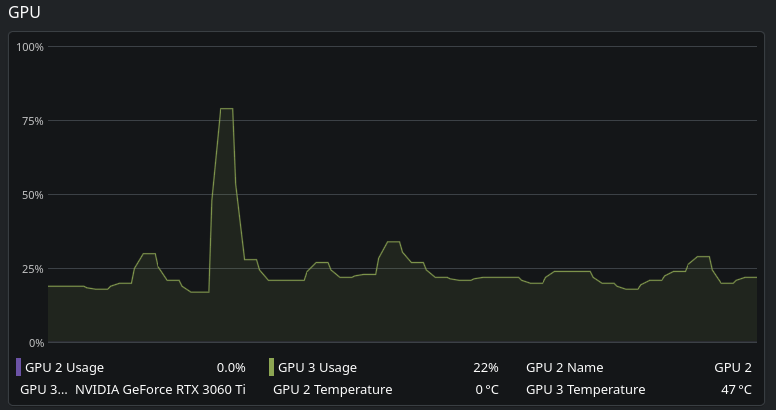

a handful of gpu questions, but namely how do i see my intel gpu usage? my nvidia gpu had 10% yusage spikes before it flatlines to 0, and my desktop isnt frozen so it cant be using that, but system monitor just says “gpu 2” and doesnt read usage
kwin says its using “gpu: i915,nv_platform,nvidia,nvidia-nvswitch” as well, and im just curious what that even means

the nvidia gpu is there but not the igpu, just a mystery “gpu 2”
GPU 2 could be the igpu
I’m just guessing but if system not need system not using, if you open a video clip or game, does it change at all.?
GPU 3 is the rtx card, the name is visible
idk what GPU 2 is, it never moves, because the nvidia one should be gpu 2

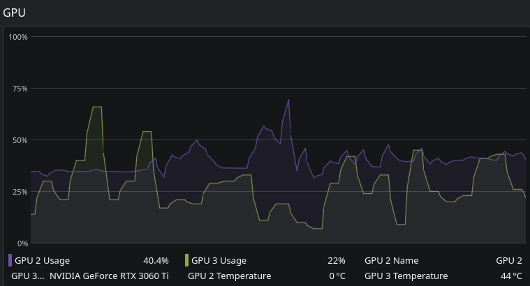

putting KWIN_DRM_DEVICES=/dev/dri/card1:/dev/dri/card2 in /etc/environment got it to both detect the igpu and fix the gpu load order somehow
