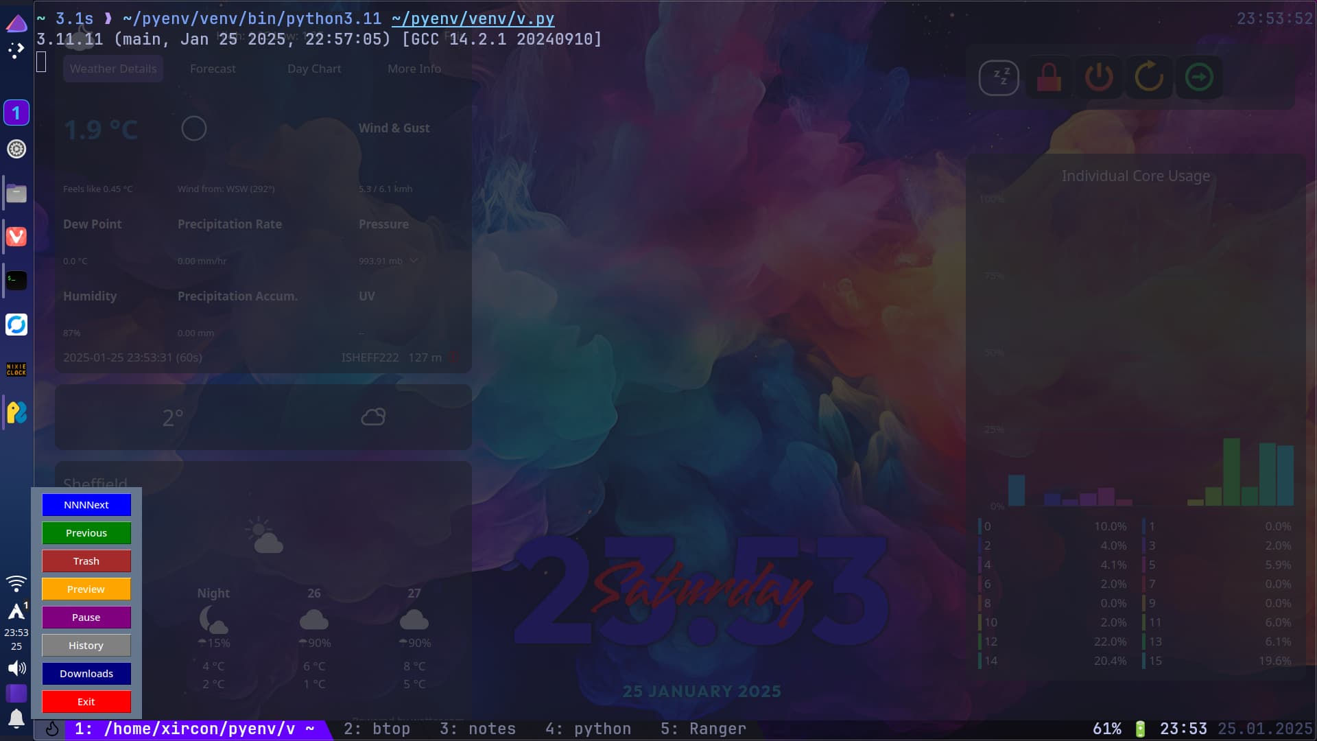

Had some coffee :smiley: I added it so that when I ran it with the venv deactivated it proved (to me!) I was running under the correct version.
The script is just a button bar to control variety wallpaper changer.

3.11.11 (main, Jan 25 2025, 22:57:05) [GCC 14.2.1 20240910]
## Deactivate venv:
(venv) ~/pye/venv 3.7s ❱ deactivate
## Run script with paths specified and no venv:
~/pye/venv ❱ cd ~
~ ❱ ~/pyenv/venv/bin/python3.11 ~/pyenv/venv/v.py
