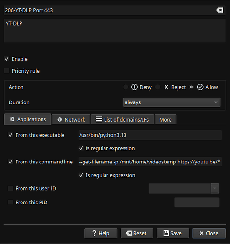

There is another detail that may be useful for some applications you come across in Opensnitch. An image is easier to explain for this one but with YT-DLP, for example, you will need to set this rule (preferably during the pop-up window) as “run from command line” and also tick the box for regular expression.
With YT-DLP every time it’s used with a new video it will pop up a new window, and this is because it’s a new Youtube ID in the URL each time and Opensnitch will think it’s a new “application” since the full path of the command doesn’t match. So what I done is place a * at the end so then it will work no matter what video you are downloading. YT-DLP needs to be done this way because if the rule is set only to “from this executable” it will actually be applying the rule to python3.13 and this rule will affect any application that uses python3.13 rather than just YT-DLP.
YT-DLP is just an example I used for this, but this could be useful to know for other applications too especially if the rule involves blocking as this would block python3.13 for everything if “from this executable” is checked. Same goes for some other applications where they are shared. Also I don’t have 200+ rules, I have 38, the rule in the image only says 206 as I kind of have groups of rules, it’s not necessary but just something I do to categorise.

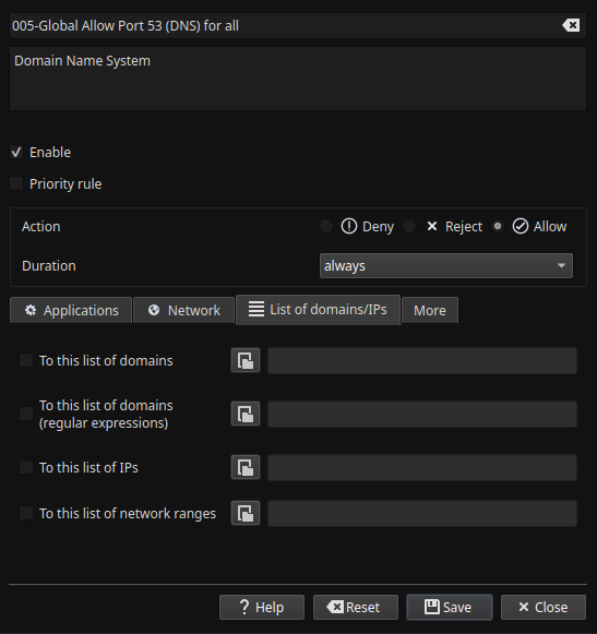

If it’s a new software it could be placed in block rule that is above the priority of my allow port 53 rule temporarily to see what it connects to, Opensnitch has an events page so you can see what applications try to reach.
Or I haven’t tried it yet but in the Global allow rule for port 53 I can attach a list of domains like in the attached image, so if I monitored which DNS domains my applications connects to I could add the ones I am fine with here (as all my applications don’t use too many domains in total and mostly access the same ones), so if a malicious software tries to reach somewhere else it should get flagged or blocked, but this still wouldn’t stop the developer suddenly making their application malicious. For other applications where it’s not clear what domains they are going to reach to add them in a list, such as peer-to-peer software, I can just add the application to a temporarily allow rule for 1 hour or one time access.
Wireshark can be useful for this scenario but the malicious application would already be allowed to make the connection at this point and not blocked.
