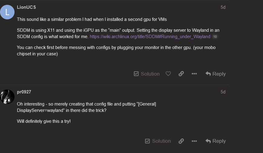

This sound like a similar problem I had when I installed a second gpu for VMs
SDDM is using X11 and using the iGPU as the “main” output. Setting the display server to Wayland in an SDDM config is what worked for me. https://wiki.archlinux.org/title/SDDM#Running_under_Wayland
You can check first before messing with configs by plugging your monitor in the other gpu. (your mobo chipset in your case)
Oh interesting - so merely creating that config file and putting “[General]
DisplayServer=wayland” in there did the trick?
Will definitely give this a try!
