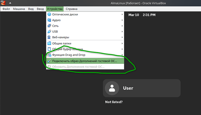

I installed almalinux in VirtualBOX in EOS Ganymede, but cannot install additional iso in VM.
I have installed virtualbox-iso package and Almalinux display iso in VM.
But when I click “Install additional iso“ in the menu of Virtualbox when VM running, Virtualbox don`t react to this. I still can use Vm, but this button “Install additional iso“ do nothing.

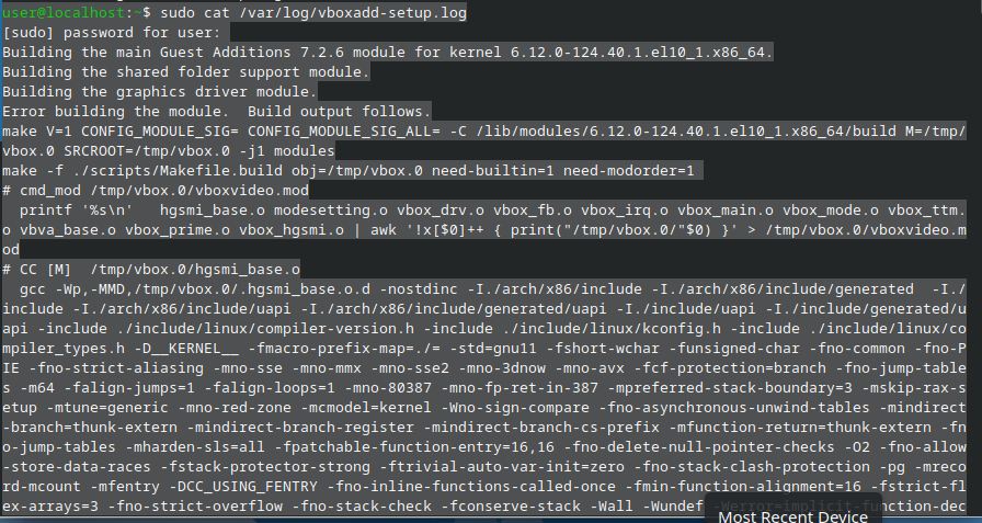

In the shell i see only this:
Qt WARNING: QObject::disconnect: wildcard call disconnects from destroyed signal of UIInvisibleWindow::unnamed
Hmm it seems to be killing some process possibly the one needed in this case but the message is quite vague

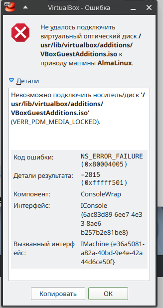

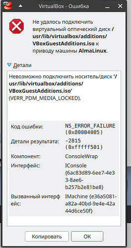

Failed
(VERR_PDM_MEDIA_LOCKED).(VERR_PDM_MEDIA_LOCKED).
