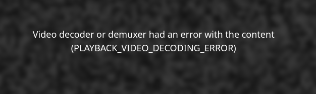

I am running into an issue when trying to play a stream on a website. I have updated the intel-media-driver, and ffmpeg is up to date. I am not sure how to troubleshoot this, here is a screenshot of the error;

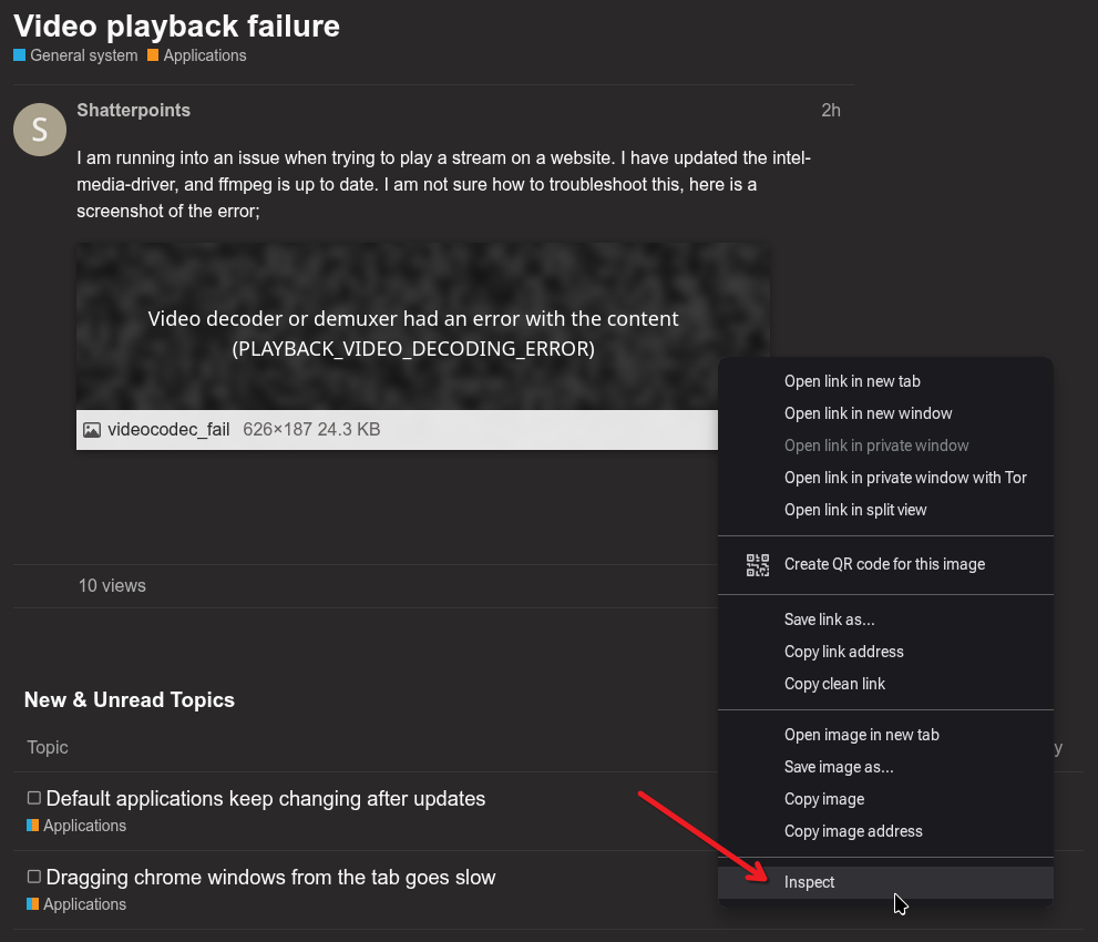

To troubleshoot, the first thing I’d look at is any browser console output. It’ll usually present more meaningful errors. This is accessed via the dev tools, in both Firefox and Chromium derivatives (right-click > Inspect):

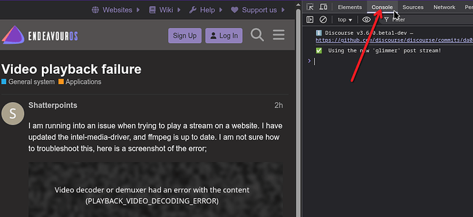

Then select “Console”.
Hopefully, when doing this on the streaming site with the issue, a useful error is provided.

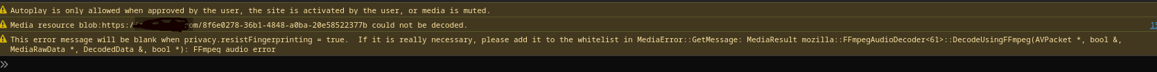

When I do this, the error gives some more info but is still cryptic. I am not even sure why bitmovin is what is being used;
