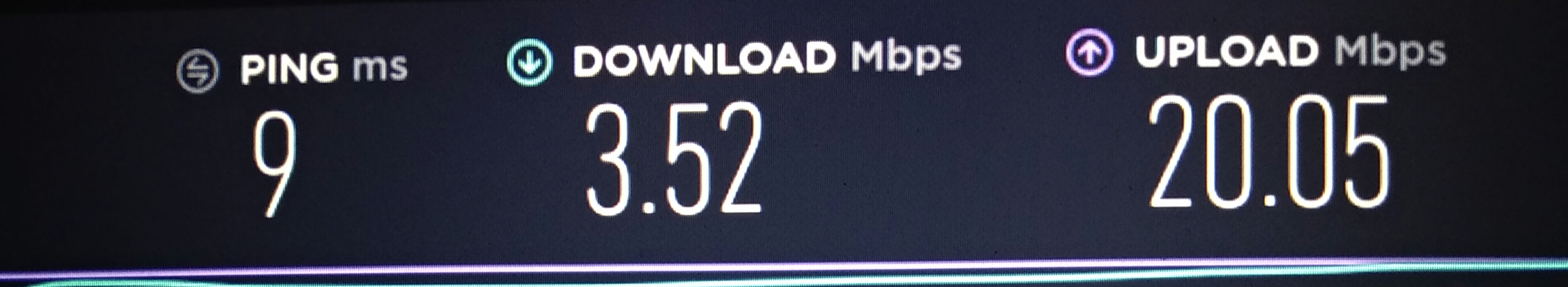

Clonezilla backup restored. I’ve found that if I get closer to the router, the speed increases, but only on the 2.4 GHz line. I got 70mb in 2.4GHz and 3.5 mb in 5.0GHz (with 20mb upload…).

Just a thought, have you tried rebooting the router?
Also, check that there’s not a bandwidth limiter or some other QoS active on there.
Yes. Nothing. :pensive:
Are you able to try disabling the n mode directly in the router?
