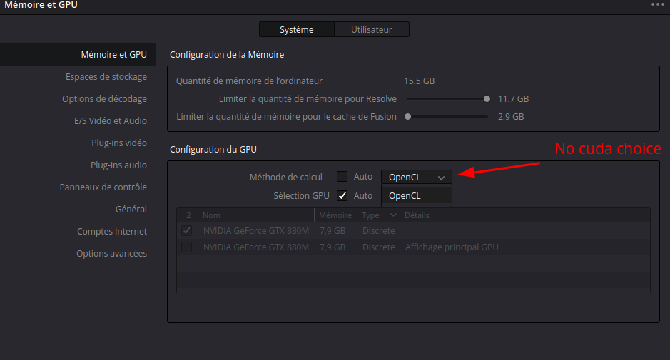

Cuda is already installed, I installed it when trying to find a solution to my problem, but it doesn’t show in Davinci Resolve:
PS: language on my system is in French as I am French.
Cuda should be a choice here (Davinci Resolve settings panel):
