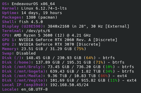

First off here are my specs (I’m going to remove the 2060):
I have an old gaming PC I repurposed into a home server and installed EOS on it. Everything was fine for a while but suddenly after a kernel I started getting boot errors. Please see the screenshot for the messages

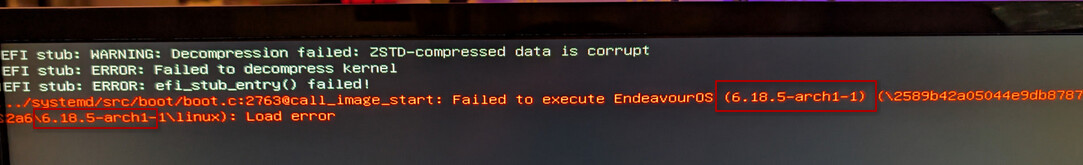

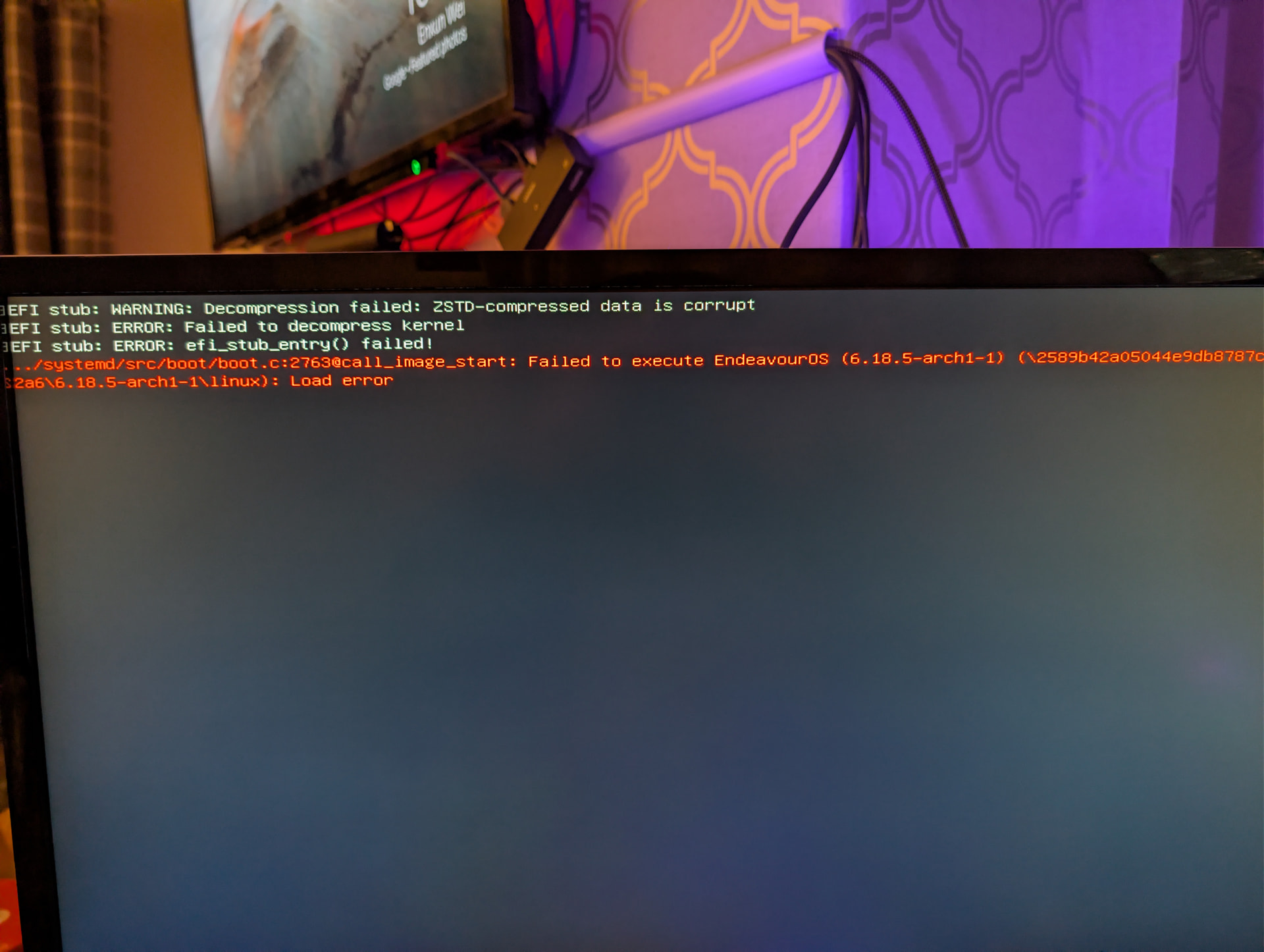

The system would try to boot twice before kicking me to the BIOS. The weird thing here is I would change nothing in the BIOS, exit without saving and the system would boot. However if I left the BIOS by saving and rebooting the system would loop back to the above.
So on choosing exit without saving at the BIOS and getting the system back up I would find a random BTRFS filesystem would be corrupt and read only (I have 3, my home partition, an NVMe drive and a mechanical drive). Generally i’d copy the data off the affected drive, reformat the drive and be free of corruption. Until my next reboot and the cycle repeats.
I found eventually that the LTS Kernal at the time didn’t cause this issue (6.12.74-1) so I stuck with that kernel until EOS updated the LTS kernel passed this point. I added the working kernel and the relevant packages to pacman.conf pkgignore.
Obviously this isn’t ideal so i’d like to resolve this somehow. I’ve searched this for weeks and have come up short so turning to you lovely lot in the hopes someone has a clue what’s going on or can point me in the general of a fix.

What brand and model power supply (PSU) are you using in that system? To power all of those components (and there’s a lot), you’d need at least a decent 700W PSU.
I’d suggest removing some things. The Nvidia GeForce RTX 2060 would be my pick as a simple thing to remove and test, but you might also try unplugging the power of the non-essential hard drives.

It’s a picture I had taken back at the time I initially tried to diagnose this issue. I’ve tried it over a couple of kernel versions with same results
