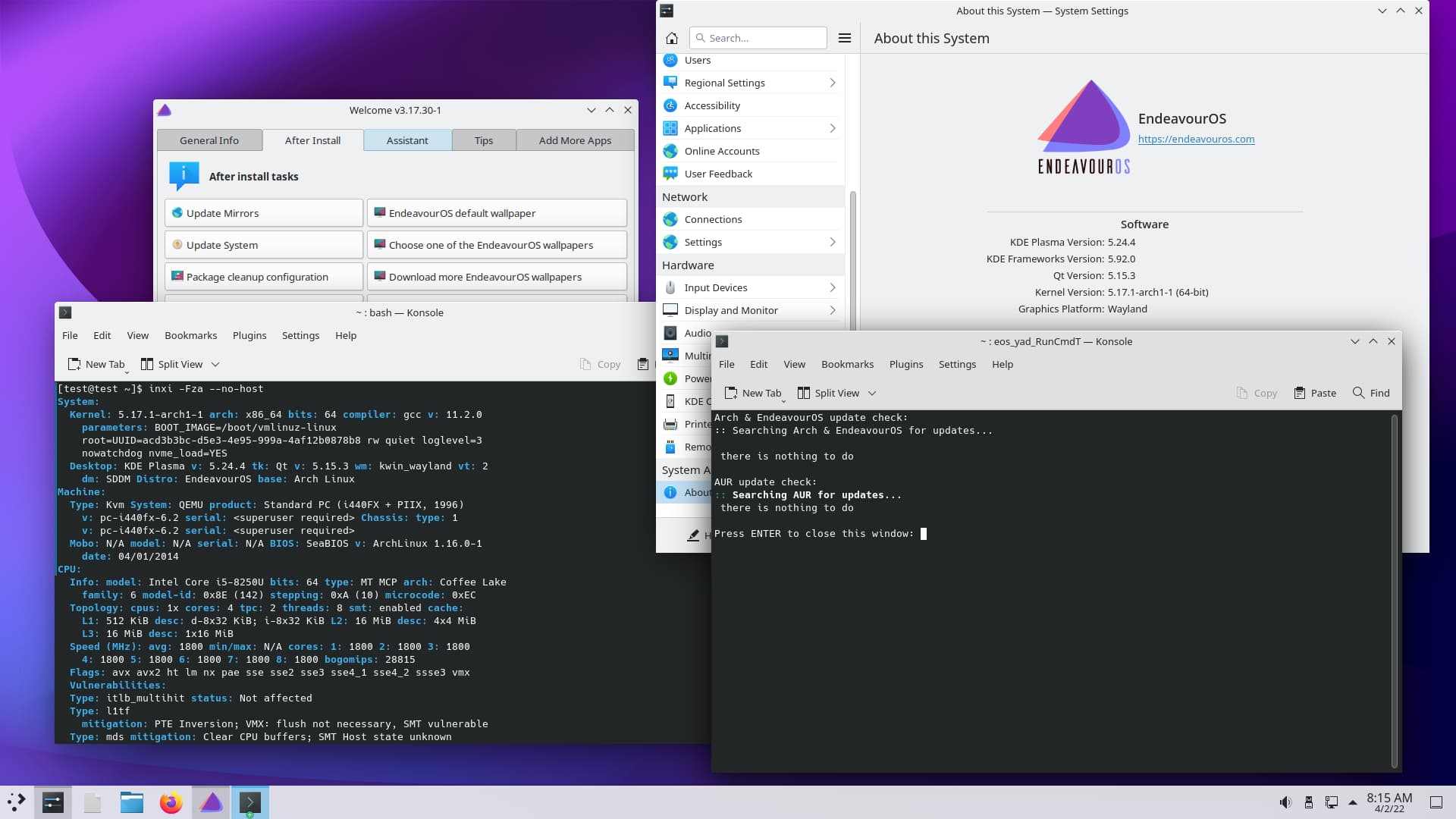

I’ll start a vm and see if I can recreate it in plasma wayland.
EOS + plasma-wayland-session. Everything works as expected here too @manuel they must have some other config issue.

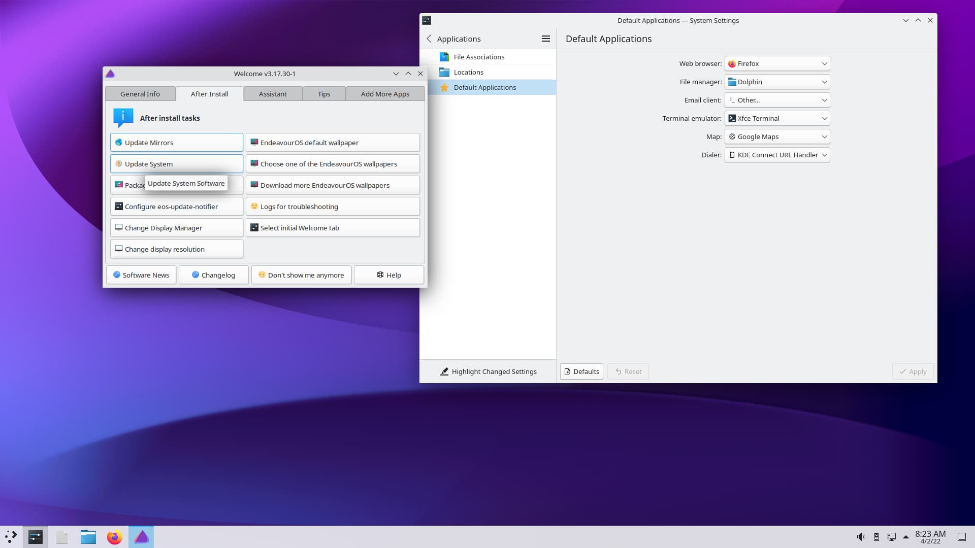

as far as i understand @endbob (nice username b.t.w. :wink: ) is using xfce4-terminal under plasma?
And have set it to be used for eos-yad services?
Can confirm - when making xfce4-terminal the default application - the update button in welcome app no longer works when I click on it.

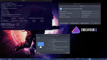

looks like xfce4-terminal is getting lost under qt and wayland … do not know how to appear properly :wink:
It’s not just QT/Plasma; on my other eos installation Gnome Wayland has the same issue.
Also both were working fine until April 1st.

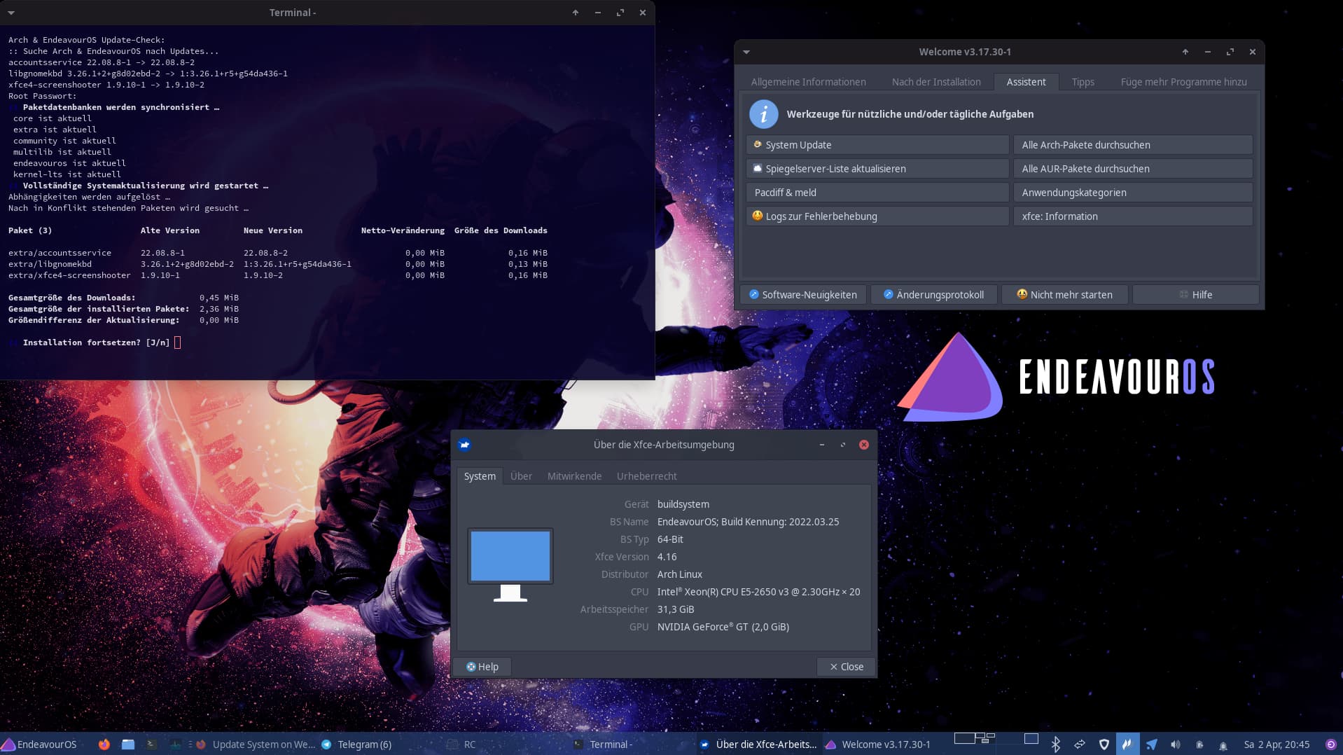

so the issue could be … xfce4-terminal running under wayland. also it was not an issue before it could be it now…
2022-04-02_20-42

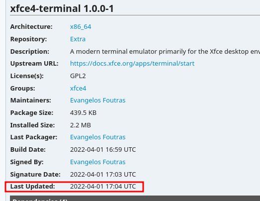

you could try downgrading it to version before…
sudo downgrade xfce4-terminal
As it is indeed also working with xfce4-terminal under xfce4 and also on other xorg based WM/DE
Felt sure that was going to work, but…it didn’t :frowning:

indeed … i suggest downgrading xfce4-terminal only… as it was updated on 1. April…
I did, and it didn’t make any difference.
