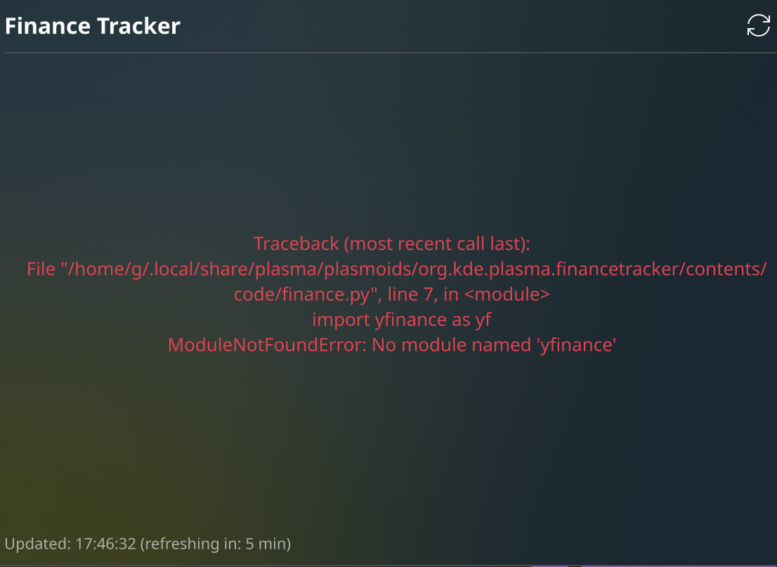

Trying to get Finance Tracker widgit working
Right now this is what it shows.
So I install yfinance using python-pipx.
$ pipx install yfinance
WARNING: Skipping setuptools as it is not installed.
  installed package yfinance 1.4.1, installed using Python 3.14.5
  These apps are now available
    - sample
⚠  Note: '/home/g/.local/bin' is not on your PATH environment variable. These apps will not be globally
    accessible until your PATH is updated. Run `pipx ensurepath` to automatically add it, or manually modify
    your PATH in your shell's config file (e.g. ~/.bashrc).
done! ✨ 🌟 ✨
Now I am not sure what the message at the end means about PATH environment variable. Can someone explain what the message means?
,and adding yfinance did not fix the widgit :face_with_diagonal_mouth:
PATH is a special environment variable that lists directories to search for executable commands. When you type a command (like cd, cp, ls etc.) without a full path, e.g. bash looks in directories like /usr/bin and other directories defined in your PATH to find the program.
In your case, apparently the directory where the app/binary is installed to is not in your PATH according to the message you posted.
You could list your PATH, in a terminal: echo $PATH
You could add the mentioned directory to your PATH:
or,
First make a backup copy of your current .bashrc. Then add the following line at the bottom of .bashrc:
export PATH="$HOME/.local/bin:$PATH"
After that, run source .bashrc in a terminal.
That was about PATH. Now if this will make your widget work, I don’t know. I’m not that familiar with KDE Plasma and its widgets.
