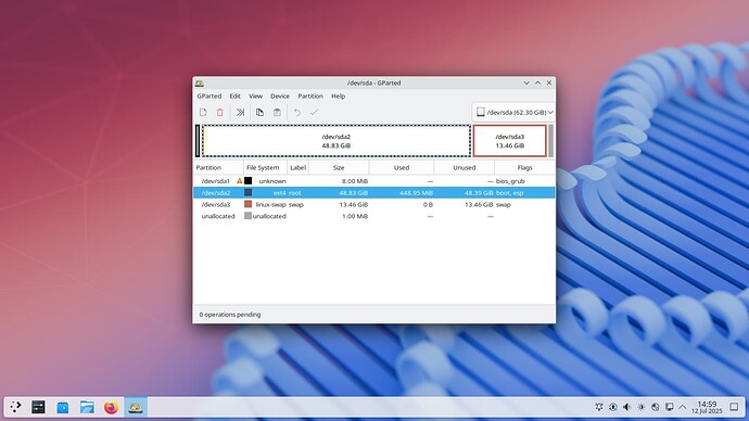

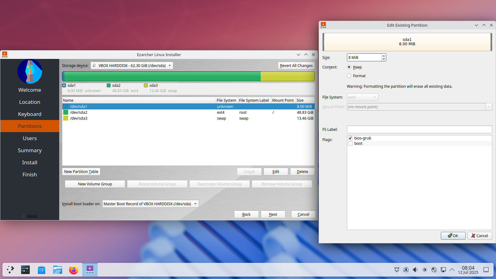

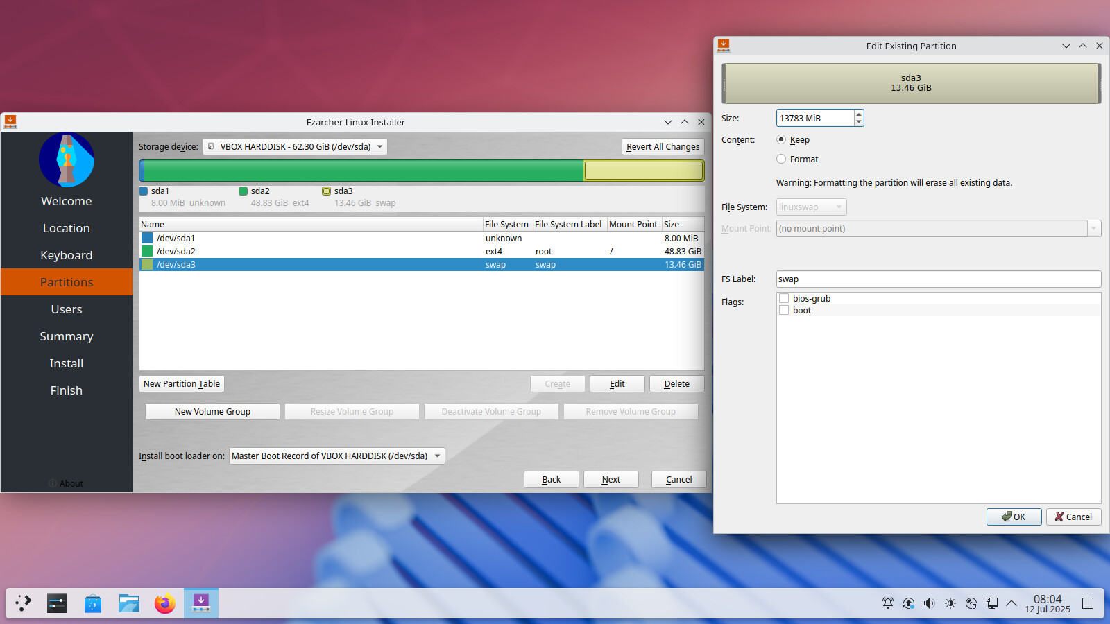

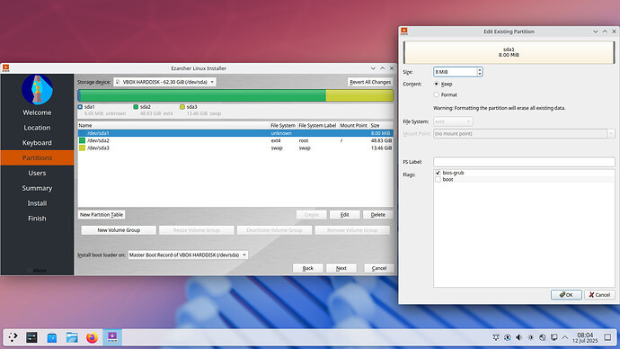

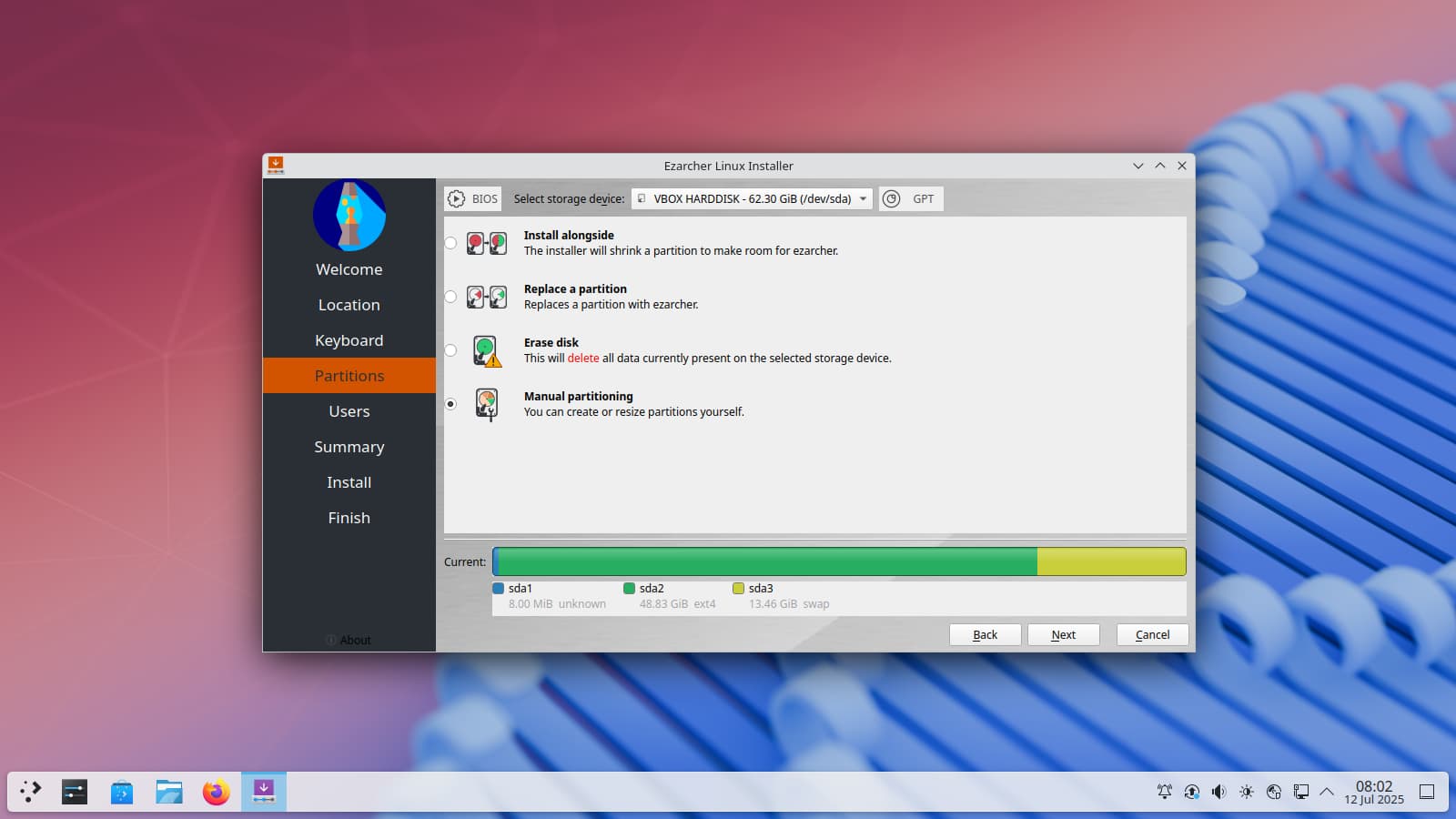

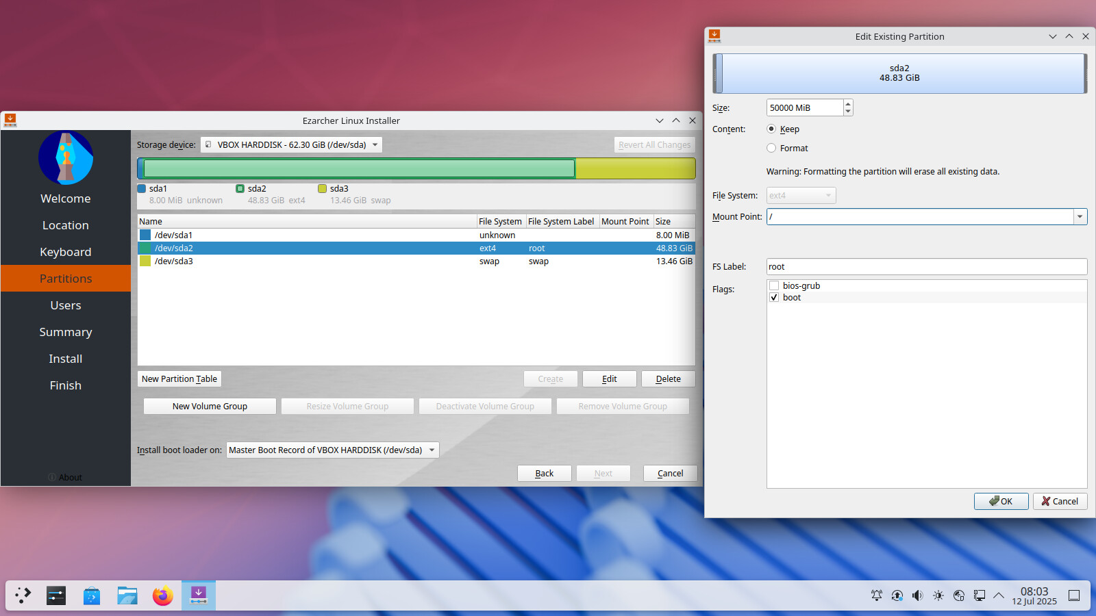

I realize this is not EndeavourOS, but Ezarcher is Arch based and uses Calamares, so it should be similar enough.
Begin by selecting Device and create a GPT formatted disk, create the following partitions:
Reboot and select manual partitioning in Calamares:
Don’t change anything about the bios_grub partition:
Select the / mount point for the ext4 partition:
Don’t change anything about the swap partition:

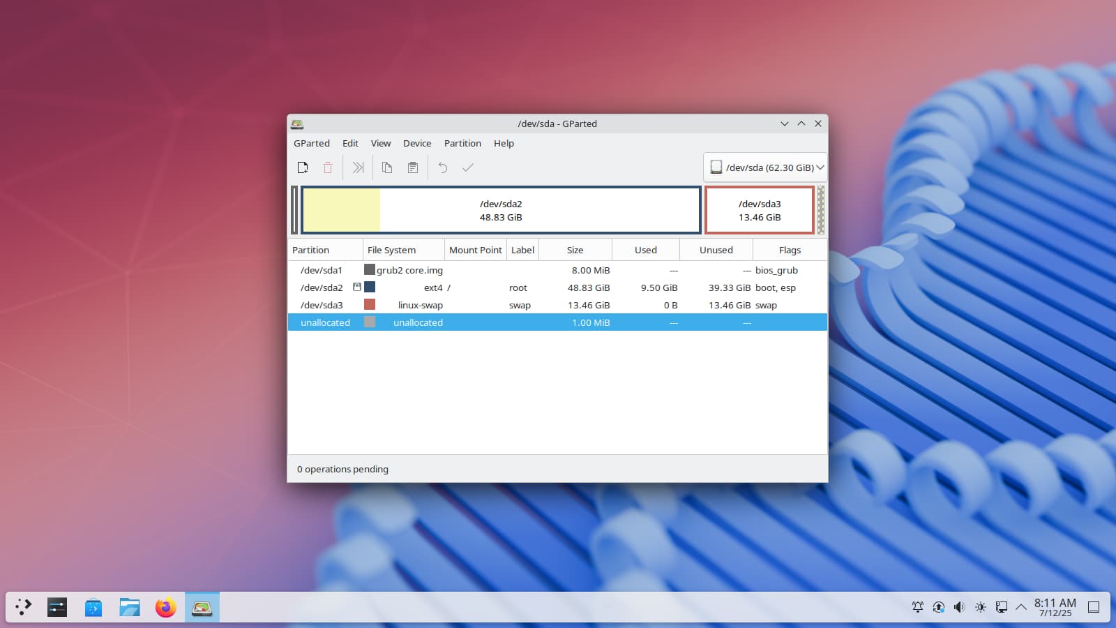

Post install, this is what it should look like:
Ah! Hang on, if it was previously formatted to ext4 and you select do not format, it will still be ext4. Have you tried deleting and recreating the partition?
It worked! I followed your instructions and it worked! Thank you so so much.
