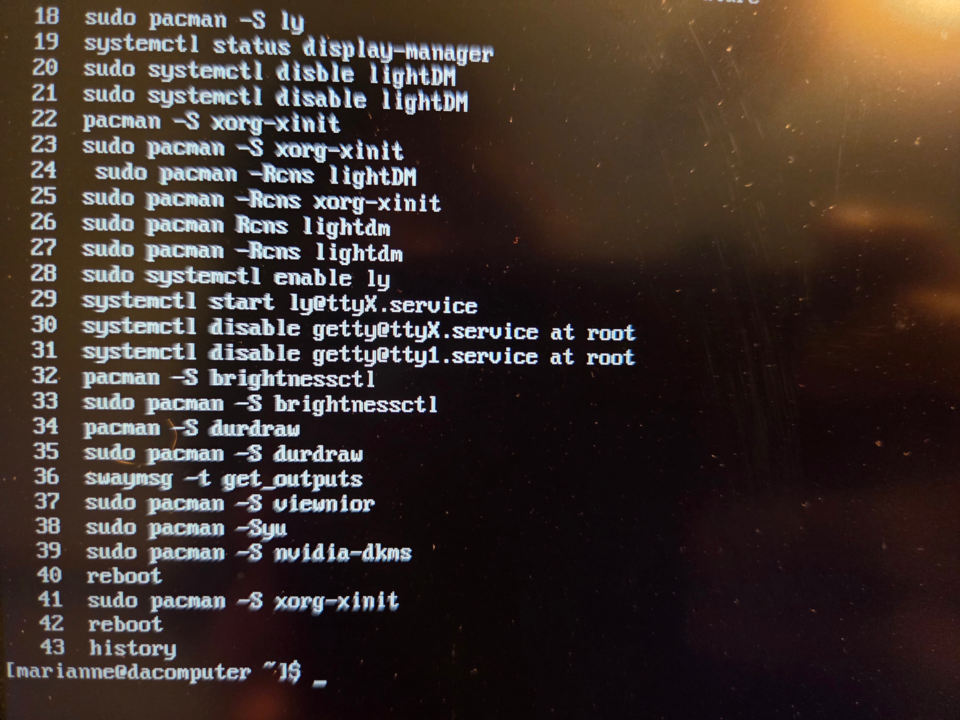

Here is every relevant command i have done.
I think the problem was me deleting xorg-xinit, but i tried reinstalling it and that didn’t fix the problem.
Help would be greatly appreciated, i am pretty new to linux in general
To enable ly, you need to specific a tty, like this:
sudo systemctl enable ly@tty2.service
Reboot, then you should be good to go.
