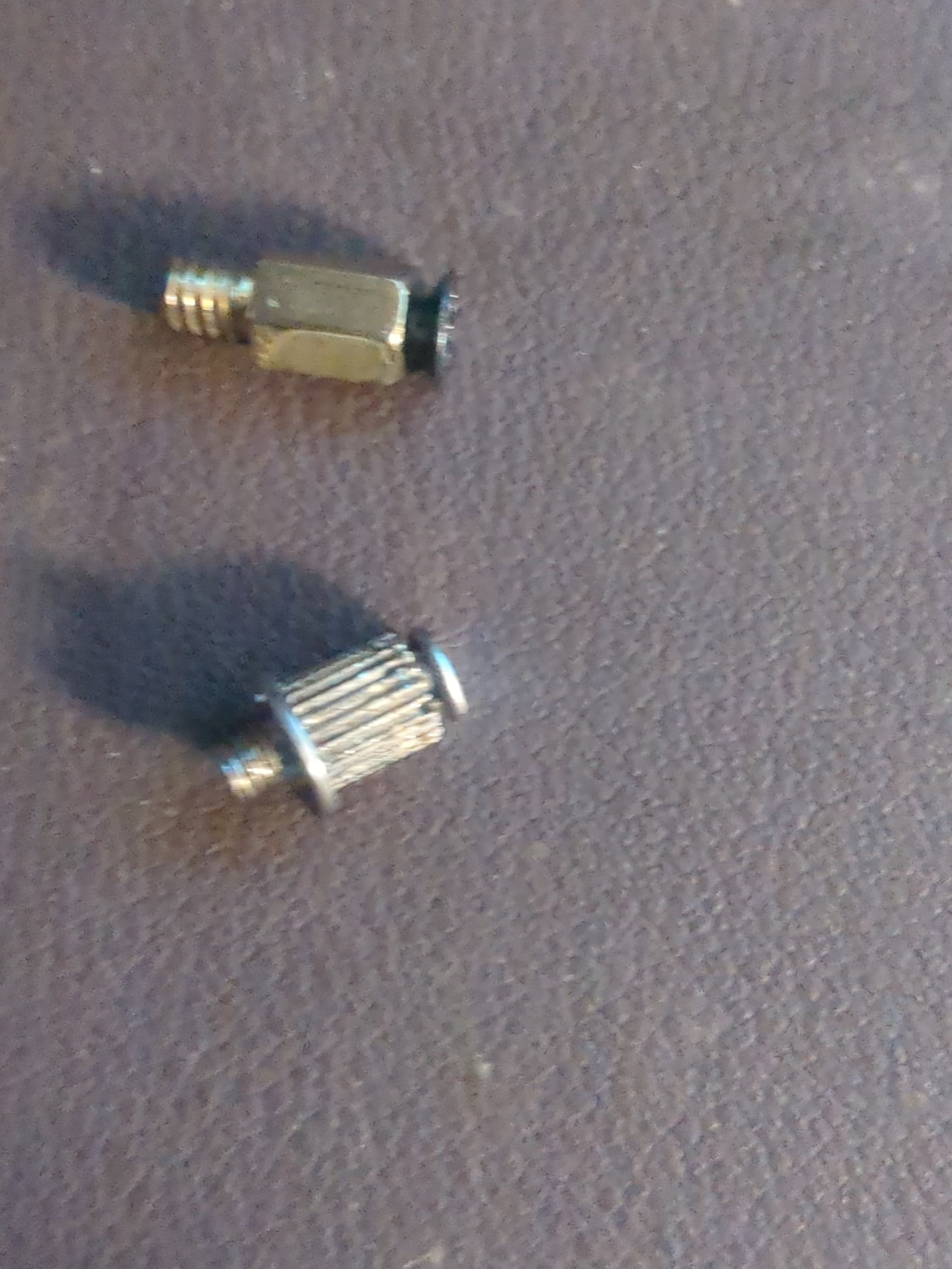

Well, it’s in there. That little bugger was a pain to install; primarily because the hardware MSI gave me to use wasn’t quite long enough to give enough threads past the NVMe drive to bite into the motherboard. Fortunately, I had other hardware (always save any leftover MoBo hardware from previous builds).
That doesn’t seem to make sense since the screws that hold down an nvme drive are usually all the same. They are very tiny but they screw into the mounting posts that the nvme drive sits on top of. :thinking:
I don’t know what to tell you, going to a slightly longer screw solved the issue for me.
there’s maybe what? 4 threads there? Not enough after adding thickness of the drive itself.
That doesn’t screw the board down. That’s a stand off that screws into the case and the board sits on top of that and a small screw holds the board down screwed into this post. :thinking:

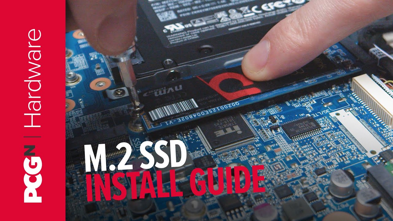

Edit: That’s why i posted the video to make sure you are mounting it correctly.

That’s not what they gave me. However. I do have a standoff like that in my hardware collection
I typically only install in desktops and i haven’t seen one like this with the plastic on the top of the standoff but there are all different types. I would think it’s the same on the laptop as shown in the youtube video. The one you have shown doesn’t have a screw in the top of it?

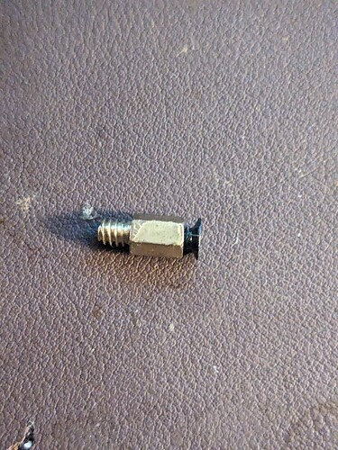

It did not, I checked, but I do have this in my hardware collection
I’m just not sure how you were screwing it into the laptop before. It would seem that the nvme drive would not be parallel and up off the surface?

BTW that standoff doesn’t look like the right type as the thread is too course. Normally the standoff have a finer thread and the top screw is way too big.

I found some screws that fit the MSI supplied standoff. I’ll try those
That looks better. It’s just to hold the m.2 drive in place. Doesn’t need to be very tight.
