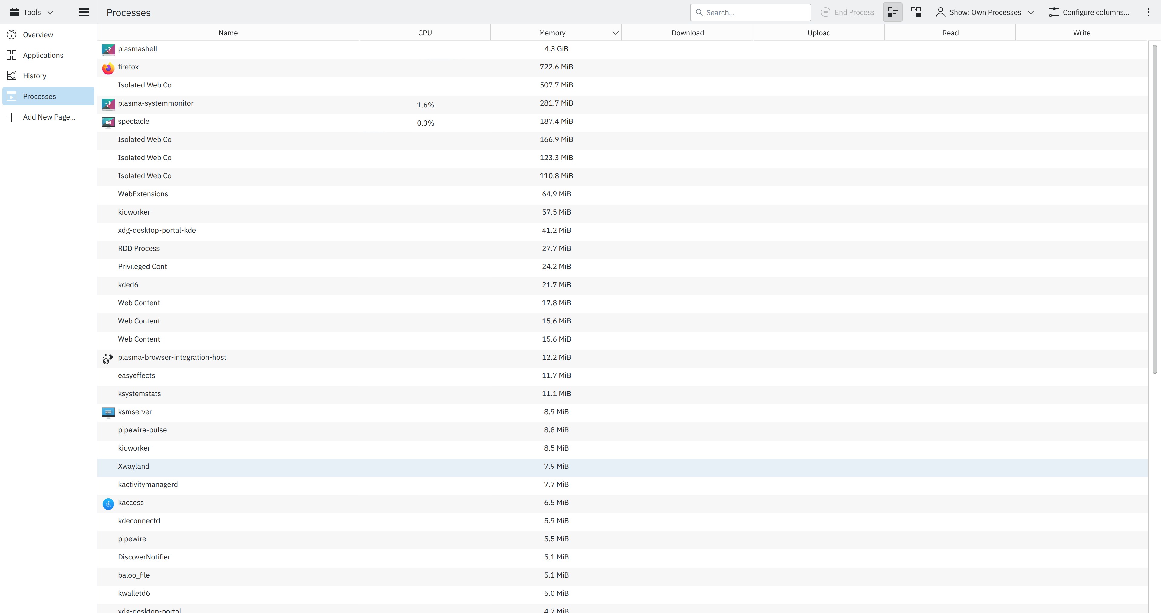

Some problems found so far:
  • CPU and Memory usage widgets crash the entire shell if I clicked (expected behavior is to open a popup with detailed information). I thought it was the old version, I removed it and installed it directly from the widget panel, but the problem persisted. It’s not exactly a problem, since I only need them to view system information, I just don’t click.
    Screenshot_20240218_124141
  • I’m finding the memory consumption excessive, at least on my system. It’s starting with 1.8~2GB, whereas previously on Plasma 5 it was somewhere between 1.1 GB. When I open Firefox, watching a simple video on YouTube and the forum tab open, it was consuming 7.2 GB. I opened 2 more tabs now, from a Google search and a shopping site and it jumped to 10.5 GB!
    Is there a memory leak somewhere?
    I looked at the system monitor and the plasmashell was consuming half of the total RAM usage. Firefox at 2 GB, the rest are other KDE applications in the background.
  • From time to time I notice some stutters in the system. Using the FPS extension, it shows that kwin is framepaced, running between 58~60 fps all the time. Then when you open some applications, or use something like YouTube in 4K, the stutters are a little more aggressive, going at 40 fps. It could be due to the Nvidia driver, I’m using the 545.

Usage is currently very low. I went to lunch, closed all open apps and left just the desktop empty. When I started using the PC again, the usage was no longer as high, now it is around 6 GB. When I monitored earlier, the one that increased memory usage was the plasmashell.
About the widgets, they are Total CPU usage and Memory Usage. These are widgets that already come with Plasma, I added them to the taskbar.
I’m also using Weather3, which I downloaded from Github, but I’ve already tested without it and it doesn’t seem to be the culprit (but maybe it’s the culprit of the memory leak, I’ll test again without it).
