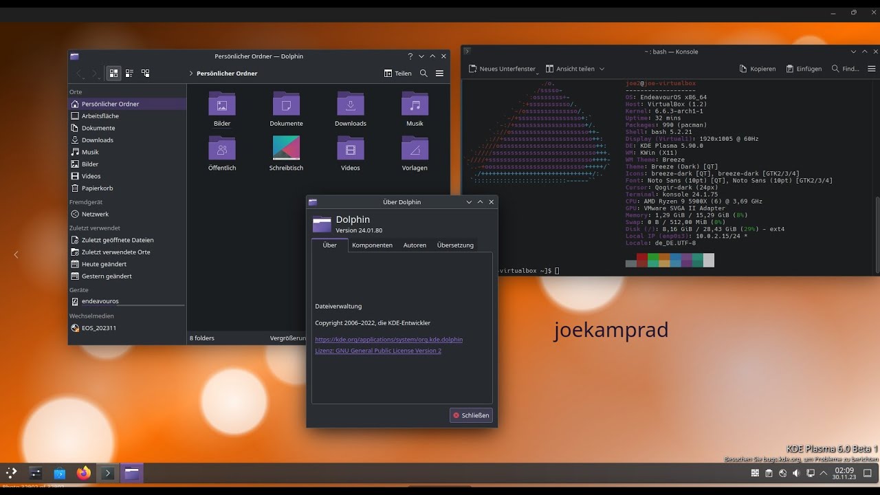

KDE 6 looks good - I had to change one simple setting (remove the “floating” from the main panel) and that’s that. Will test a bit. Next up: Set up Galileo with Wayland and upgrade to plasma6.
testing again installimng from Galileo ISO without Desktop.
