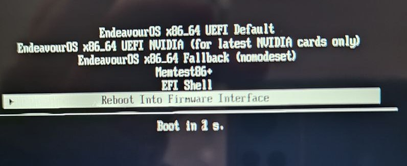

Systemd-boot: reboot into firmware - long standing issue?
Trying to install eOS on a Dell Laptop, reboot into firmware seems the default. Moreover, the issue seems to be long standing as reported first a few years ago. Any ideas? Thanks.
Have you tried to set the default option in the bootloader?
No. I prepared an eOS boot stick, inserted it into the Laptop and saw it enter BIOS instead of eOS to install it.
The issue could be nailed down to the latest BIOS version from March 2025:
Inspiron 14-5406 2in1
BIOS Version 1.35.0
It does not happen on other hardware. Any ideas which setting could be the culprit? Does anyone have a Dell Laptop out there?

I have an old-ish Dell Latitude E6510, BIOS version A17. On this, it does select the topmost EOS boot option. But “Reboot Into Firmware Interface” does nothing (what is it actually for?).
It should boot into your UEFI/“BIOS” settings.
So same behaviour as spamming F2 when your Dell starts.
Thanks. For some reason, it doesn’t, here. But anyway, my question was a bit off-topic. This machine is 12+ years old, still has a Legacy BIOS, so maybe they didn’t do the UEFI implementation too well back then.

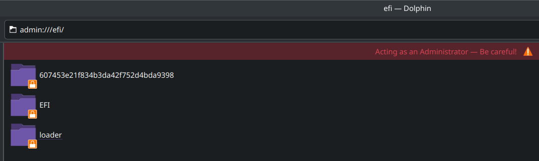

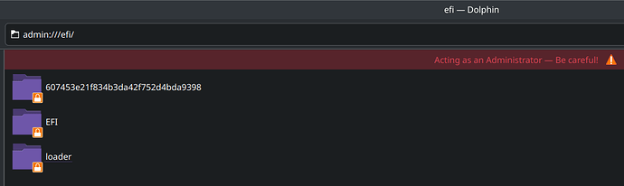

I just installed EndeavourOS & linux-hardened and tested setting the hardened kernel as the default:
nano /efi/loader/loader.conf
default 607453e21f834b3da42f752d4bda9398-*-hardened
timeout 5
console-mode auto
reboot-for-bitlocker 1
Works for me. The string of numbers & letters should be different on your system though.
$ uname -r
6.13.12-hardened1-1-hardened
You can find your string in /efi
