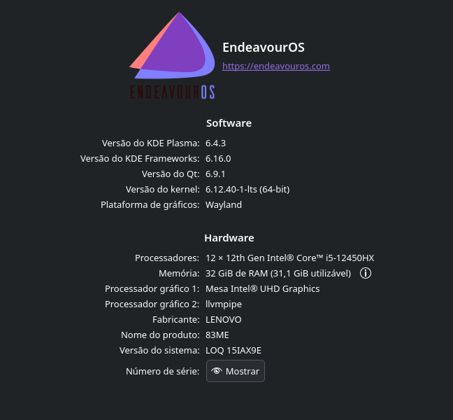

So, I recently moved to Endeavour OS from another Arch based distro and while I’m not a complete noob when it comes to Arch Linux, I simply cannot wrap my head around why this issue is happening on my installation.
This install is running KDE Plasma (Wayland) on a laptop with an intel integrated gpu + Nvidia RTX 3050 and every time I check the system information application it tells me I only have intel UHD graphics and llvmpipe running.
The weirdest part is that the dedicated GPU seems to be working normally on surface, since I can game with it no problem. However I still have the hunch that there is some else at play here.
Attached is a picture of the system information app. (It’s in Portuguese but you can see GPU 1 and 2)
Thanks in advance for the help!

I think this post’s headline should be edited, because if everything works like it should, your system is not using llvmpipe but simply displaying wrong information.
