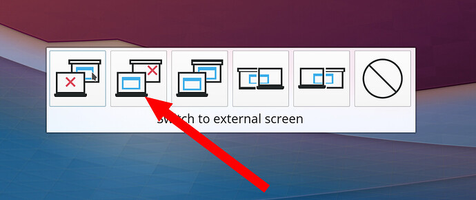

Like this?
It sounds like a bug; what you are describing I believe should be supported. You can report the bug here: https://bugs.kde.org/
yes that do nothing when I already have 2 monitors enabled. It don’t switch only to one screen.
One on left (external screen only) just switch to dual screen.
