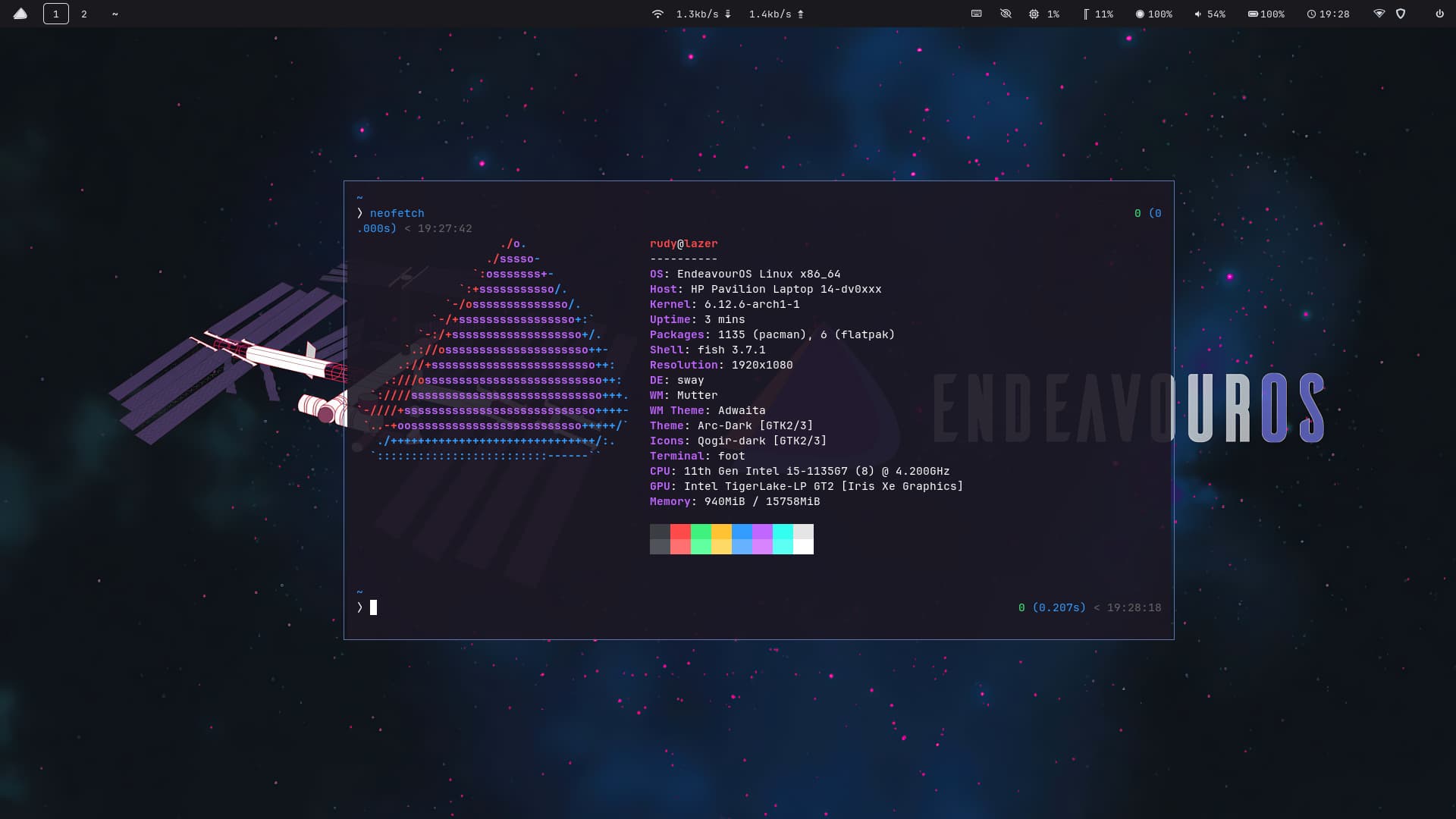

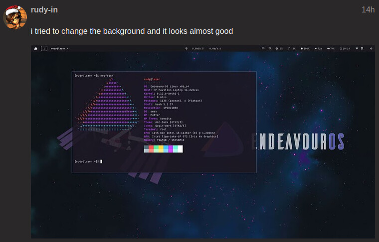

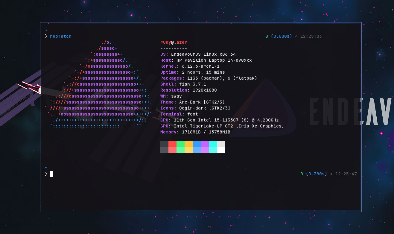

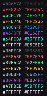

i made the colors more bright @smokey @BluishHumility
Noticable straight away, got to go offline for a bit, apparently I am a missing person, not sure how

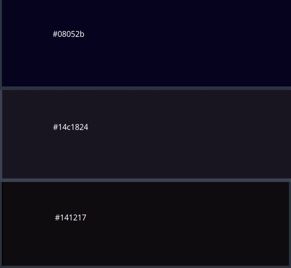

Here they are side by side, the current color scheme on the left and the new one on the right:
Those two new grey colors might be a little too dark (I’m worried text in those colors will be hard to read).
The background in the new PR is black now–we don’t want to keep a little purple in it?
#08052b is the current terminal background color.
#1c1824 was the shade in the first version of today’s PR. There is a hint of purple in there, but it’s subtle.
#141217 is the updated PR. Now it’s just black.
If there is purple left in there, personally I can’t see it.
Which color is this background?
Is that #1c1824? I think that’s the best one, it’s nice and dark but still has some purple to it.
Ok so i’ve reverted the change in the PR but i did not revert the colors
it looks absolutely good
