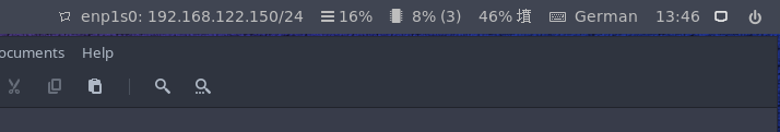

just see again that iconfonts on waybar getting screwed again?
fresh install:
2021-03-28_13-46
@joekamprad what module that icon wrong? I read lot on forum about icon/font problem but never have issues . i think wht different my setup? ( volume icon? )
Could I do the same thing as @flyingcakes? Use IsovekaNerdFont?

Same problem here with fonts. I’m investigating but I’ve not found anything to fix it for now.
strange!! still zero problem on my :thinking:
