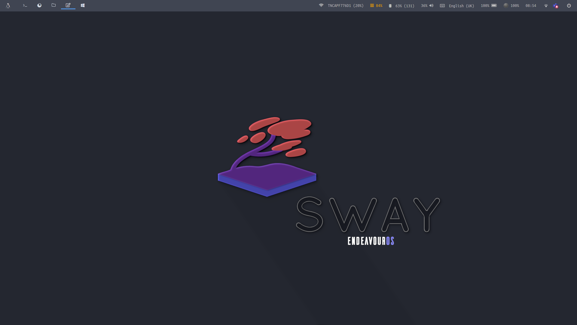

@Shjim wallpaper is perfect!
But if you use -s center
, the if the picturefile have a smaller resolution than the screen then, it will have a solid color border at the edges. That was why I was thinking -s fill
. Does that not work for you?
-s fill doesn’t do anything for me.
Swaylock fixed! The config was for the wrong swaylock fork
Which fork are we using?
The old config was for swaylock-effects - my fault- this one is for normal swaylock. The ring now matches @Shjim lockscreen as well!
s -fill works sorry!
Lets go with that then.
