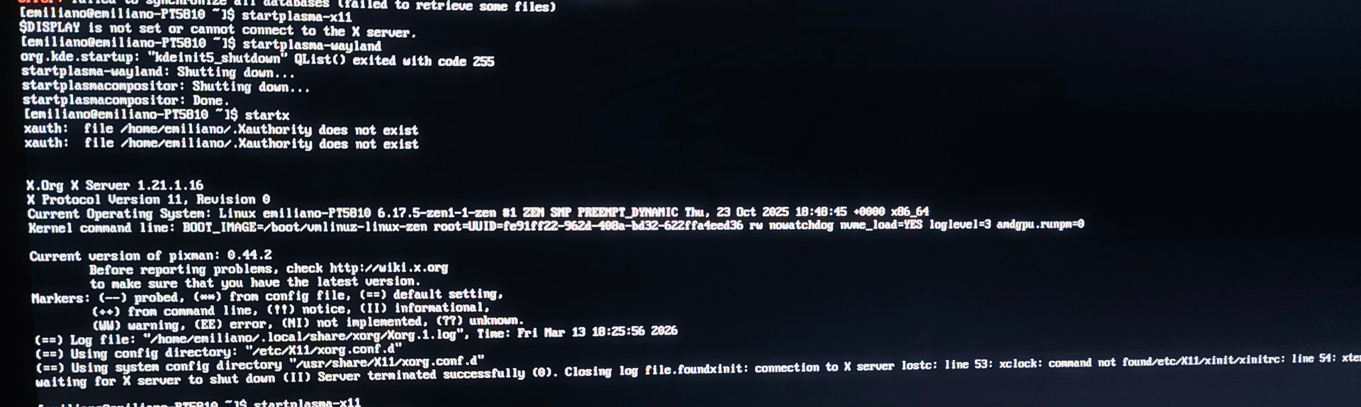

Hi, so I finally had some time to tinker: I ran startplamsa-wayland, startplasma-x11 and startx, and got hit with:

So you are using the Linux Zen kernel. That is good to know. Can you please have a look at the path /home/emiliano/.local/share/xorg that will have the various X.org log files. You will have to go with them, with the latest one first to identify what is going on.
Give the following command in the TTY/Virtual terminal, \ls -alt.
\ls = This will omit all the alias for ls if you have one.
-a = list all files
-l = give long listing, with size, owners, groups, permissions, size, name, etc
-t = Sort based on time.
Pickup the latest log file and find out what is going on.
