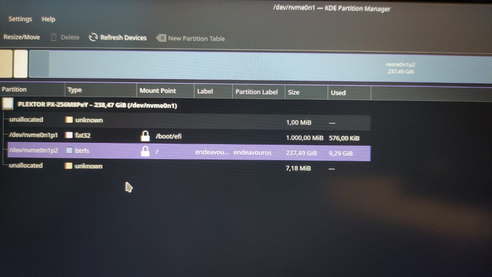

Strange install on ssd
looks strange, i have 2 unalocated parts for no reason, and is it normal that boot partition is that big. i went with default recommendation. what is the optimal boot partition size?
Nothing looks too strange to me…
First off - the unallocated at the front I assume to be aligning the sectors to a given byte boundary to enable simple usage for different file systems.
The second is quite small, actually - it is MiB not GiB. This is actually a good size for the boot/efi, as you not likely to run out!
The main system covers everything else, and should work fine. If you need/want to split stuff off (on another drive?) it is easily done, and explained on request.
The final chunk I am not sure, but I suspect the same reason - it is so small that it can’t be used with the block size of your chosen file system.
Hope this helps - or an actual expert may be along with a better explanation!
so almost one gigabyte is a good size… what would be a small amount then? when i installed garuda on another computer, on a 2tb ssd, it defaulted on 300 mb fat32 and the rest btrfs, and here is 250gb ssd and i got almost one gb fat32 and the rest btrfs
While 300 is a workable size, and 500 is fine, having more leaves room for the unexpected. One such thing might be the addition of other systems without needing another efi partition. With one that large, you COULD add several should you ever wish to…
My almost two years old EOS installation also shows a 300 MiB /boot/efi partition, so maybe the recommended size changed since then. And i got these small unallocated areas as well.
EndeavourOS switched from mkinitcpio to dracut during that time. One thing I have noticed is dracut tends to create bigger images because it includes more stuff.

1 Gig is definitely a good size if you are using dracut. I tried to manually convert from mkinitcpio to dracut and my efi partition was simply too small for the images dracut was creating. I didn’t wanna reinstall, so I decided to stick with mkinitcpio

Some unallocated space at the end of the disk is need for the GPT, else you would maybe get warnings about corrupted GPT when the file system wrote there, and the file system data would get corrupted when GPT was fixed.
I’m not a user of KDE Partition Manager, so don’t know how it handles that, and it could also just be an artifact of how the installer installed the disk anyway.
From what I have heard, NVidia drivers can take 100s of MiB for initrds, so 1GiB for EFI is a reasonable default choice, it not what you want. I guess you could fine tune that choice on install depending upon your selections, or you could reorg the partitions with gparted live USB post install, or you could not bother and leave it alone which I think is the smartest option.
Yeah pretty much. This isn’t something that I would do though, so I am not familiar with the steps. Perhaps you can adapt this guide for gparted https://www.baeldung.com/linux/resize-partitions to kde partition manager if you are dead set on using that.
