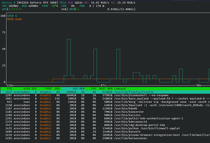

Is steam running from the igpu ?
I don’t think so. I just checked this link and installed nvtop. The GPU Select option in the application only lists NVIDIA GeForce RTX 3060. Also, steam is not listed in the list of applications currently using the GPU.
