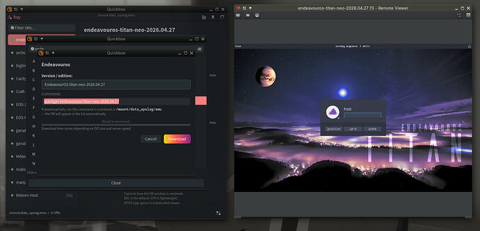

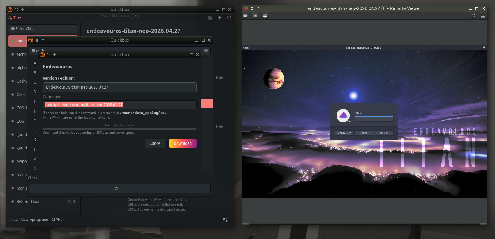

The use of quickemu.
A tool that makes QEMU really easy to download and run an ISO in a VM.
  yay quickemu
  mkdir ~/emu
  cd ~/emu
 # Download and setup vm automatically
 quickget endeavouros titan-neo-2026.04.27
Or use quickbox, a GUI for quickemu.
Quickemu GUI (GTK/QT)
  yay quickbox
:penguin:

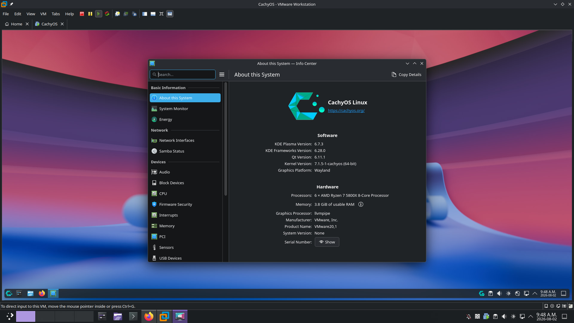

I agree there is an issue. Not sure what’s causing it. I usually use 4 GB memory and 28 GB drive space on vmware. I purposely downloaded the latest EOS ISO and installed in vmware and got the same result. It’s taking way too long to load if it ever does. I didn’t wait to find out. Instead i tried loading another distro using CachyOS. I used grub as the bootloader btw.
Installed CachyOS on vmware and rebooted into it. It loads instantly!
