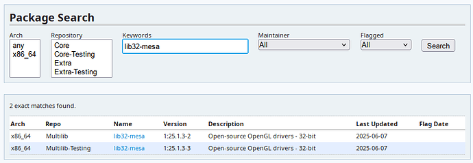

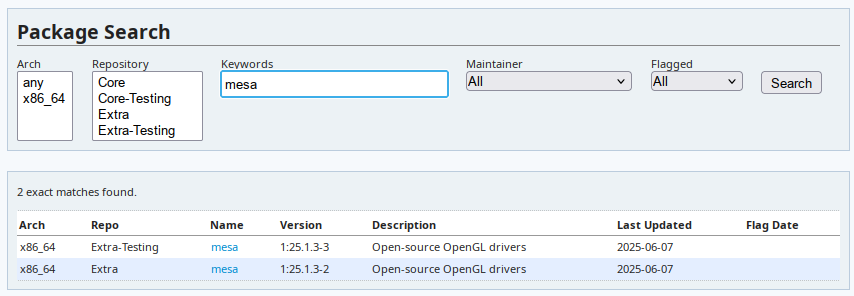

But there are updates available according to Arch Package Search. mesa and lib32-mesa have updates available from 1:25.1.2-1 to 1:25.1.3-2
However, yay and pacman return “nothing to do.”

Any ideas here? Or am I just missing something?
Maybe your mirrors haven’t updated yet
Hopefully that’s the case. I did update my mirrors.
The only reason I even posted about this was because of the recent mesa issue. I guess time will tell.
