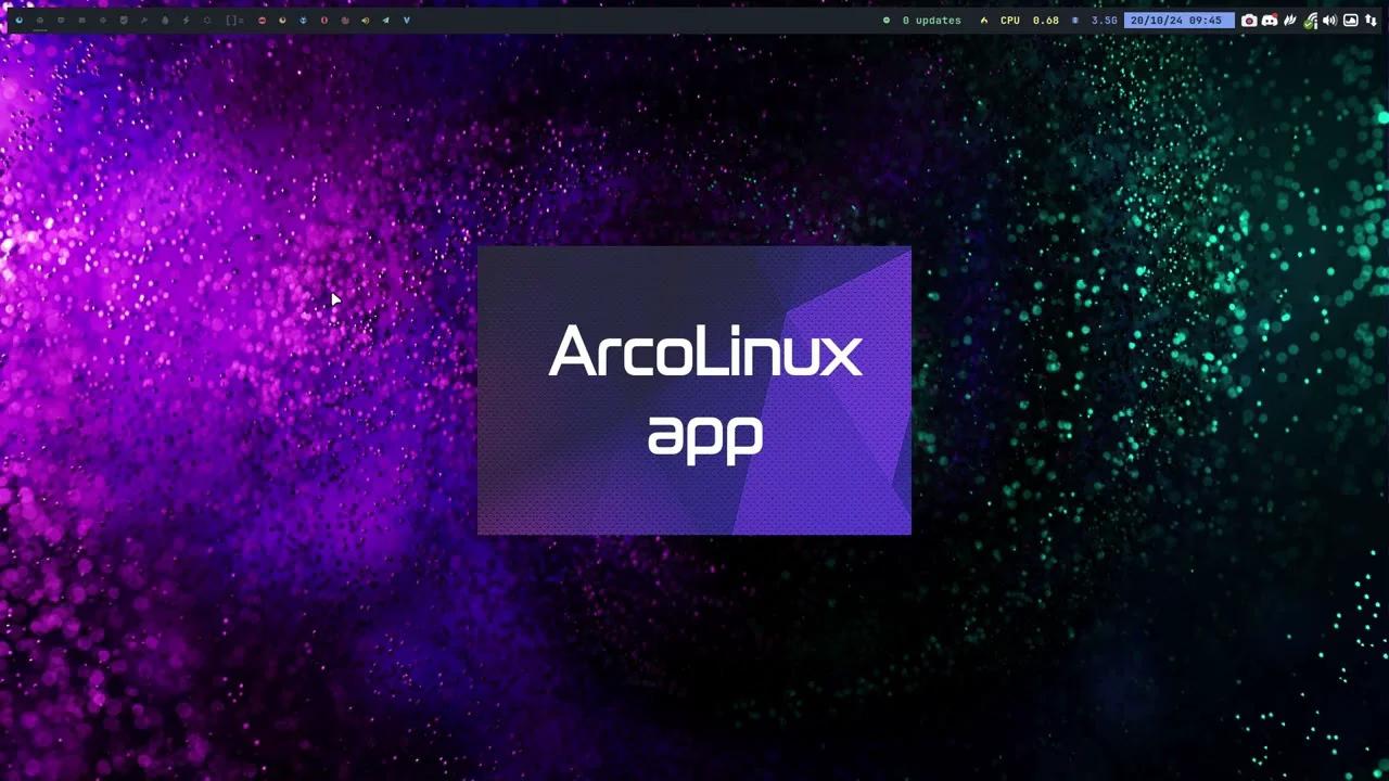

EDIT: It’s called AAG. It’s not Sofirem.
The main article: https://www.arcolinuxiso.com/arcolinux-app/
