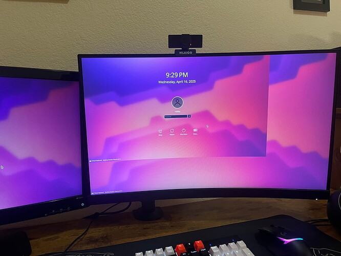

So the good new is that it fixed that. The bad news is I now get an overlay on my primary monitor in the top left that looks to be 1080 (it’s a 1440 monitor) of the login screen.
I have a similar setup with two different resolution/refresh monitors, and --auto had been sufficient. In this case though, perhaps manually setting the resolution on your primary display is necessary?

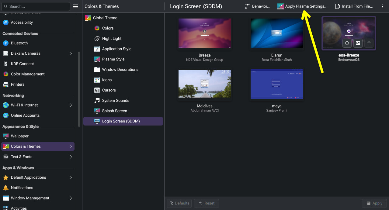

You might comment out those settings in /usr/share/sddm/scripts/Xsetup. Then logging into KDE Plasma with a Wayland session, and go to “Login Screen (SDDM)” settings.
Hit the “Apply Plasma Settings…” button, then “Apply” in the pop-up.

So upon further investigating it looks like the 1080 display is a mirror of the second display. The cursor moves on both. I can also still change between wayland and x11 on the primary in the 1440 section. I do not know if that actually changes anything but it is more information.
