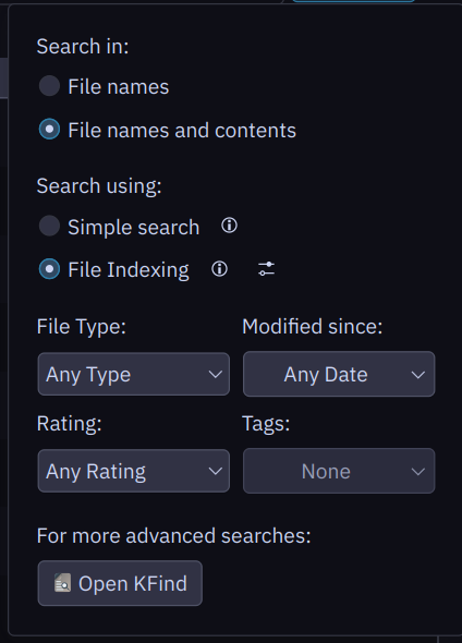

For those of you using indexing via Baloo, inside Dolphin, make sure you click on Filter and then enable “File Indexing”:
So far, it’s been solid, having just enabled content indexing, I’m sitting at 1.25GB for 10k files. Not bad!
