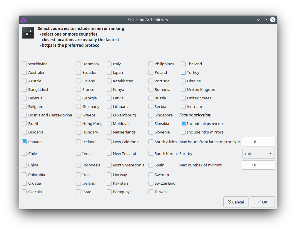

Are you talking about the update mirrors on the Welcome App?
Screenshot_20201011_175406
Yup - I guess you haven’t updated recently :grin:
Scn-refl
Notice the Use /etc/reflector-simple.conf option on this one…
Yes it’s up to date!
Must not have created an /etc/reflector-simple.conf file then - something made that option show up for me! I may not bother with it now, having tried it out, though. :grin:
Edit: just removed .conf and the option disappeared. Canada didn’t come back, though! It must think the Montreal VPN server is in the US? Good thing they don’t know that - they often think it’s bad enough to be in Canada!

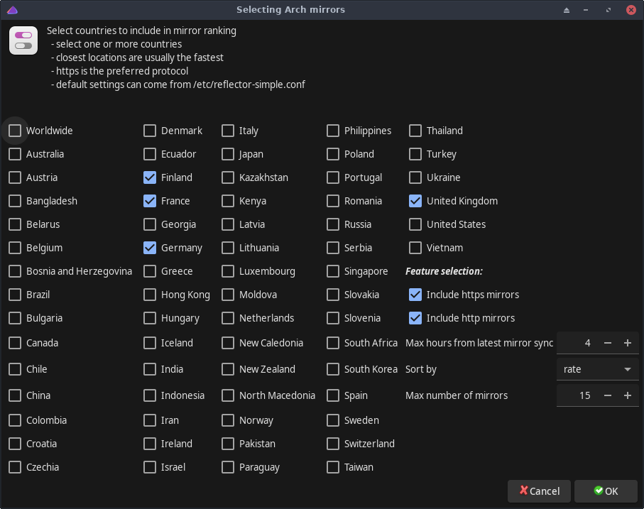

Hi all!
Just modified reflector-simple to use the /etc/reflector-simple.conf contents as the default values.
Now, the values that the GUI supports, will also show as pre-selected! :smile:
For example, if you have these lines in /etc/reflector-simple.conf:
-c GB,FR,DE
-a4
-n15
-phttp
you’ll see that the GUI shows also these values in the beginning.
Bear in mind that some defaults (like the local country and -phttps) are “hard-coded” in the program itself, so you’ll see e.g. https mirrors included.
Note also that now the usage of the config file is no more a selectable option. The file is used if it exists. If you don’t want to use it, rename or delete the config file.
This picture shows how the GUI starts with the config file contents like above:
simple
One more note: if config file /etc/reflector-auto.conf (now obsolete!) exists and /etc/reflector-simple.conf does not, then /etc/reflector-auto.conf is used.
