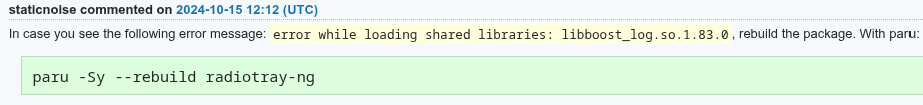

Sounds like it needs to be rebuilt. Have you tried rebuilding it?
I think @dalto 's onto something. The AUR comments include:
